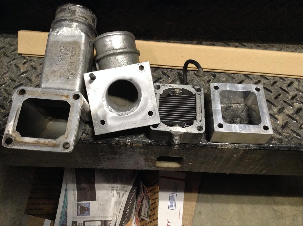

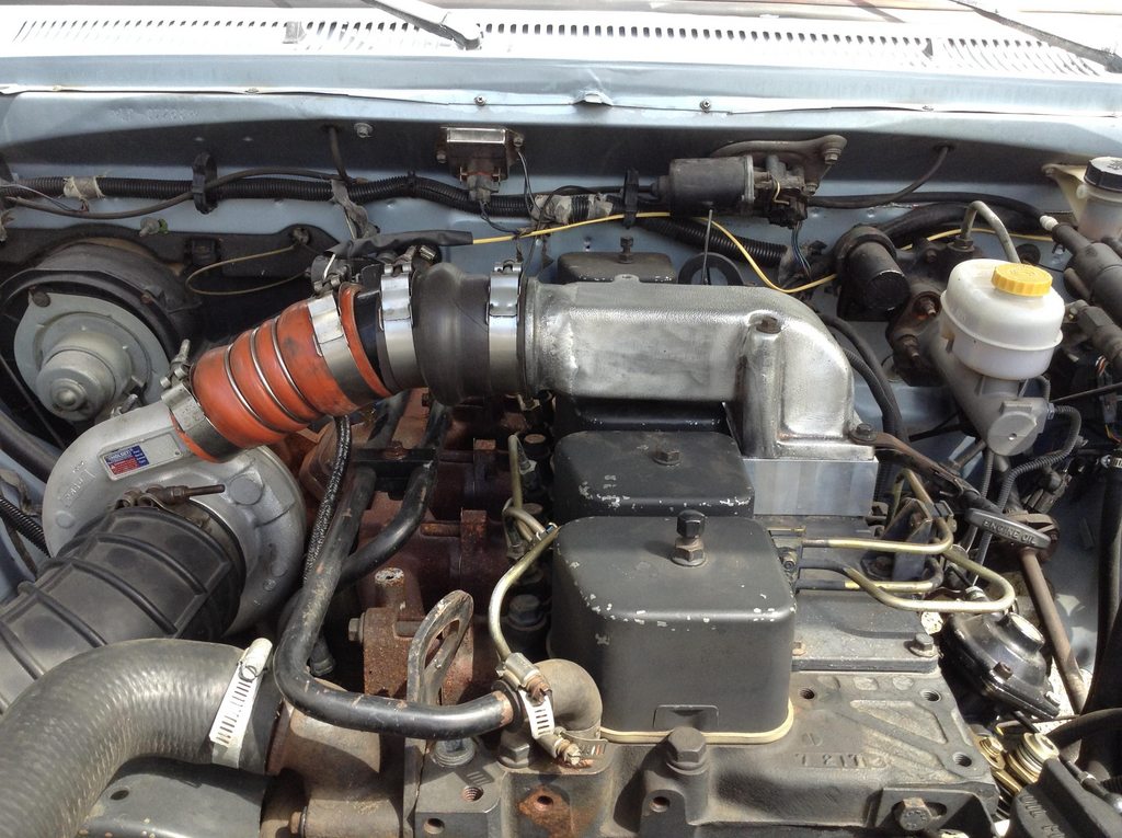

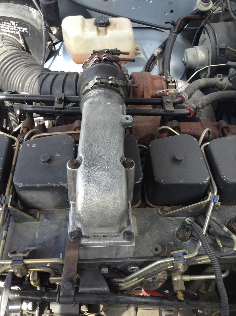

I have been driving the RC a bit now that it is summer here in VT. It is running well.
Tonight after dinner, I screwed the fuel screw in a full turn followed by backing out the low idle screw several turns and adjusting the throttle rod. That got the idle back to where it should be.
I then swapped the custom made intake horn out for another custom made intake horn I had aluminum welded up out of a 24V intake horn and a left over broken 90* turbo elbow. It has a smoother flow and a wider mouth than the last custom job. It HAS to be better at flowing air. I also swapped out the OEM grid heater block for a custom made grid heater delete block as I never drive the RC in the winter.
I will check things out tomorrow...gives me an excuse to take the family out to the diner for breakfast a few towns away to test things out....
A little more fuel and a little more air, I will see what it gets me. The EGT are pretty low so a little more fuel as long as it runs clean should be fine.
I got too much smoke under throttle for my taste with an aftermarket [THD] fuel pin when I threw one in last summer. So I am looking of a little more power without the extra smoke.

Do you happen to have a picture of that intake horn? I'd like to see the differences...

I did send some pictures of the intake horn upgrade to Thrashing to be vetted. If they pass his quality control and he has the time he might post them.
The RC has been running great. It was a little strong on initial smoke after gear changes, so I swapped out the '92 lighter spring rate AFC spring for an earlier NON intercooled AFC that is a noticeably stiffer spring. It worked great to control low end smoke without adjusting the star wheel.

Ummm....that's Trashing to you Oli....
Here are the pics of the intake horn....
