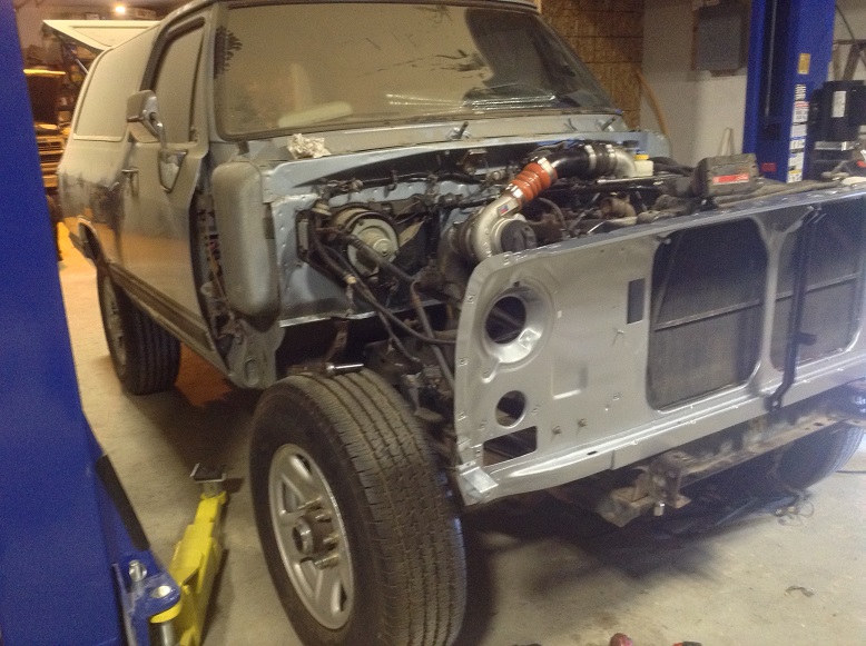

I just sent some more pictures to T-man of last weeks progress.

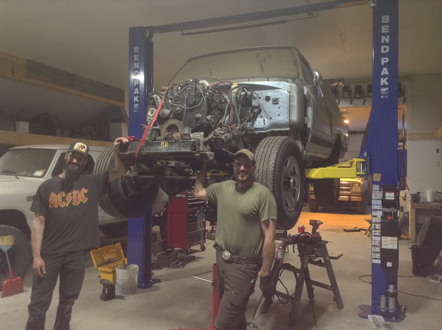

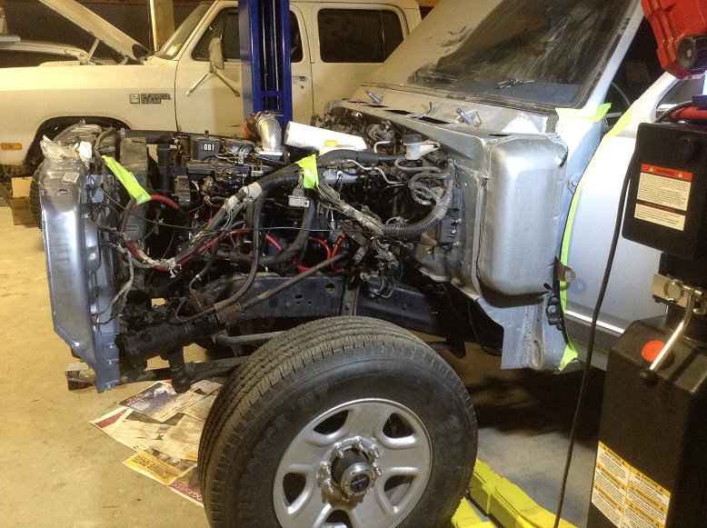

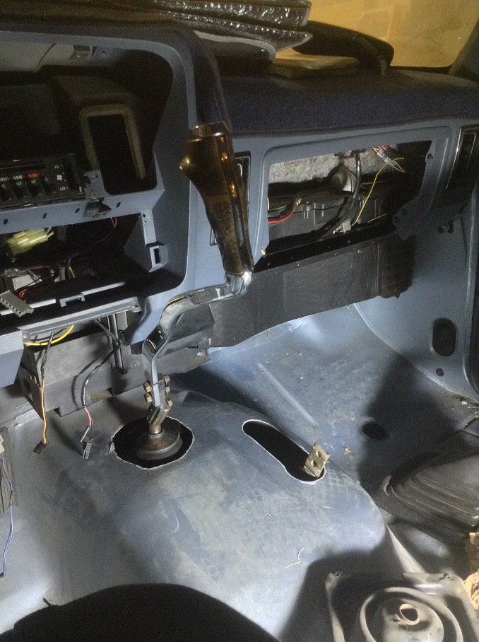

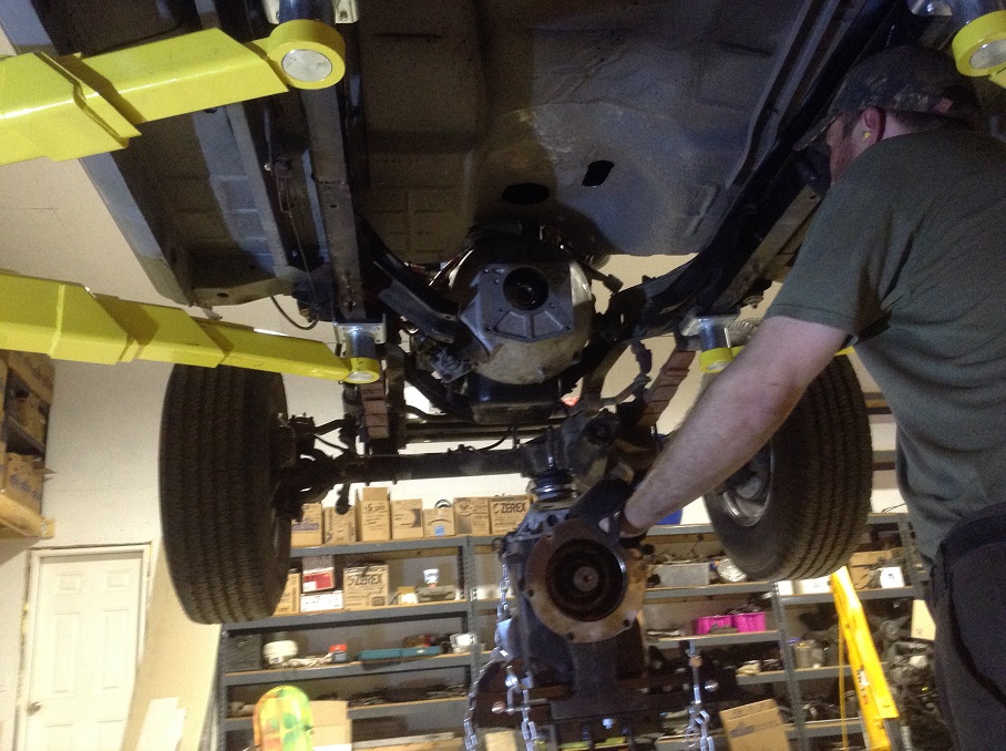

The pictures above show the transmission install.

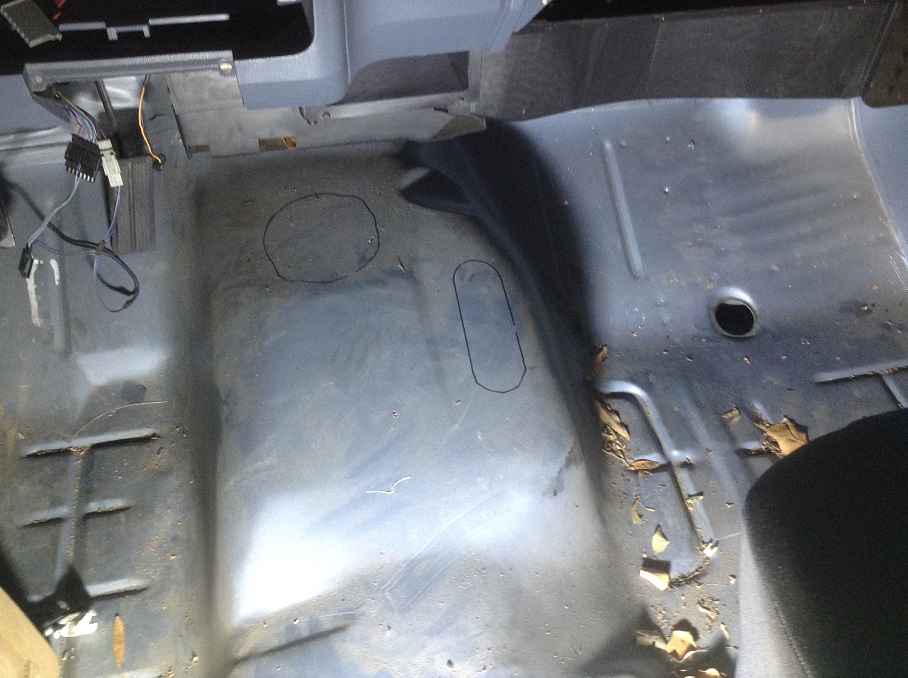

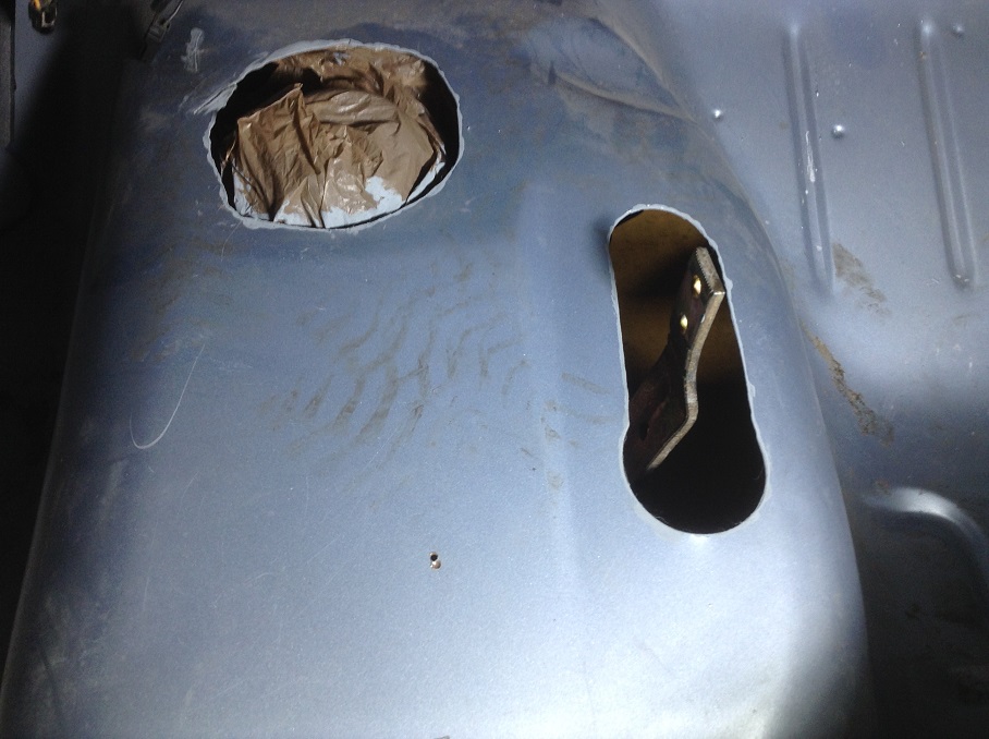

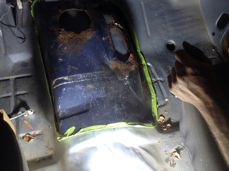

The cutting on the shifter holes using an old 4x4 5 speed transmission hump as a template.
There is also a picture of Tyler and me at the end of a long day of wrenching in front of the RC.

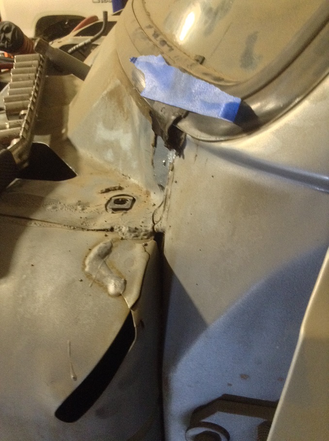

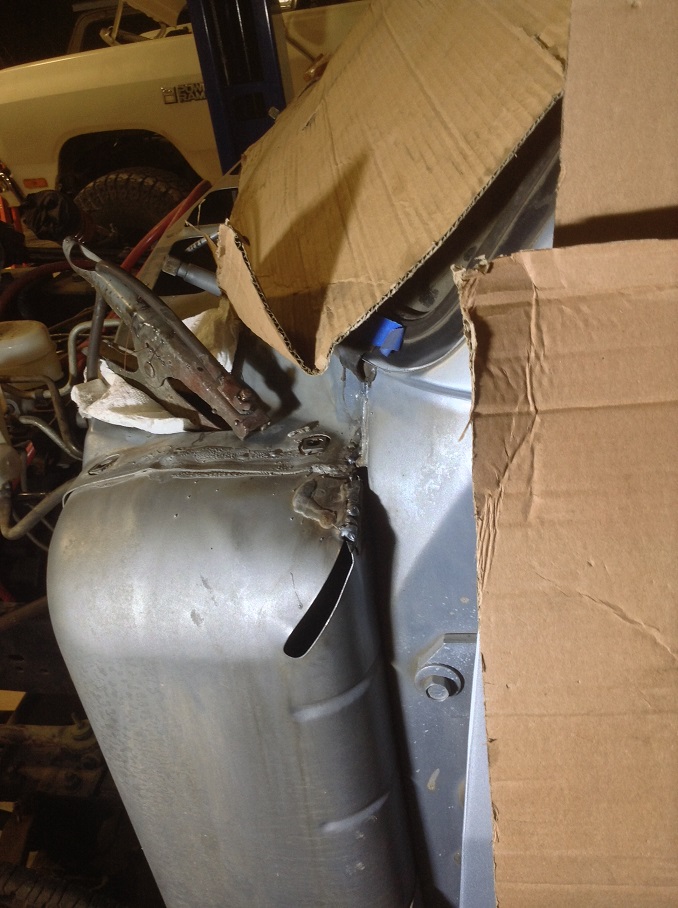

A couple of pictures show the cowl cracks that are typical of most 1st gens, and the welding I did to piece it back together.

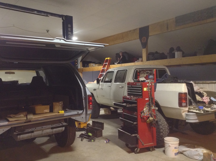

If you look closely in the one picture that has the white crew cab clearly pictured in it you can see my daughter hanging out in the Mopar loft as we work.

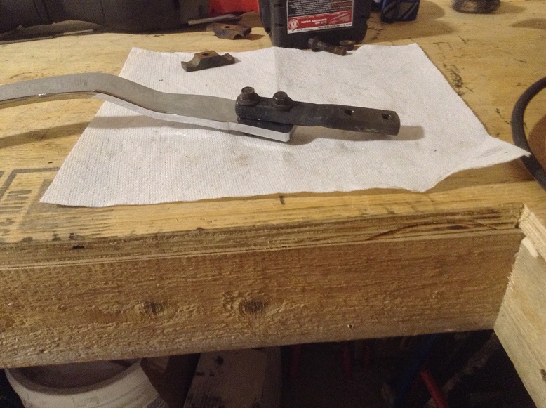

The last picture shows the '70 B body pistol grip shifter we got to work with the old Getrag...It feels totally at home after heating and bending an old Getrag shifter lower stub to get the right lean, angle and twist. We had to pull it and heat it up with the oxy/act torch several times to get it to feel just right. I now smile every time I get in it. I have wanted a pistol grip Power Wagon or RC for almost 20 years, this seemed like just the right rig for the big fancy chrome shifter.

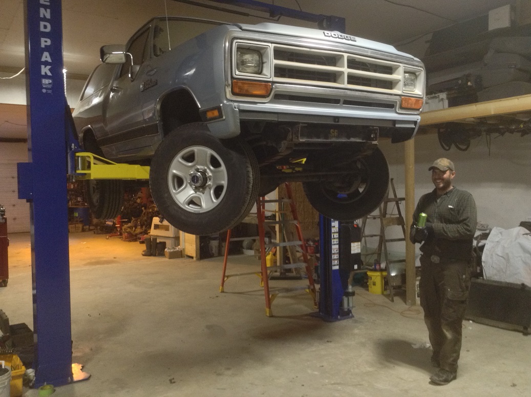

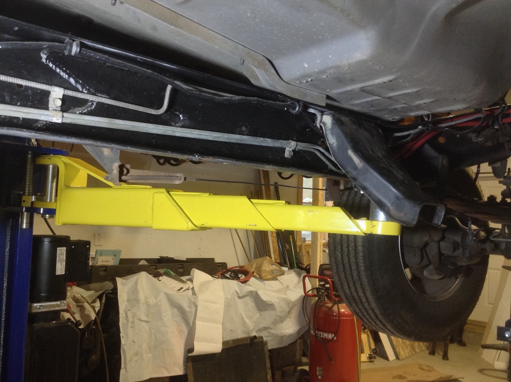

I wanted to go with that 2 post lift to save as much floor space as possible to play musical Mopar in the shop. I finally put down the tool belt and picked up the wrench again a few months ago, but the new lift only went in 3 weeks ago.

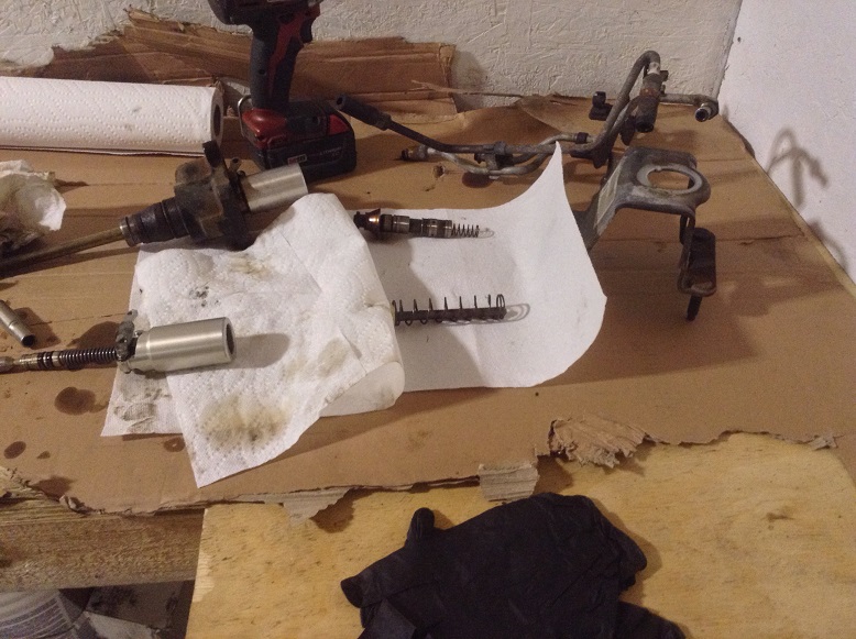

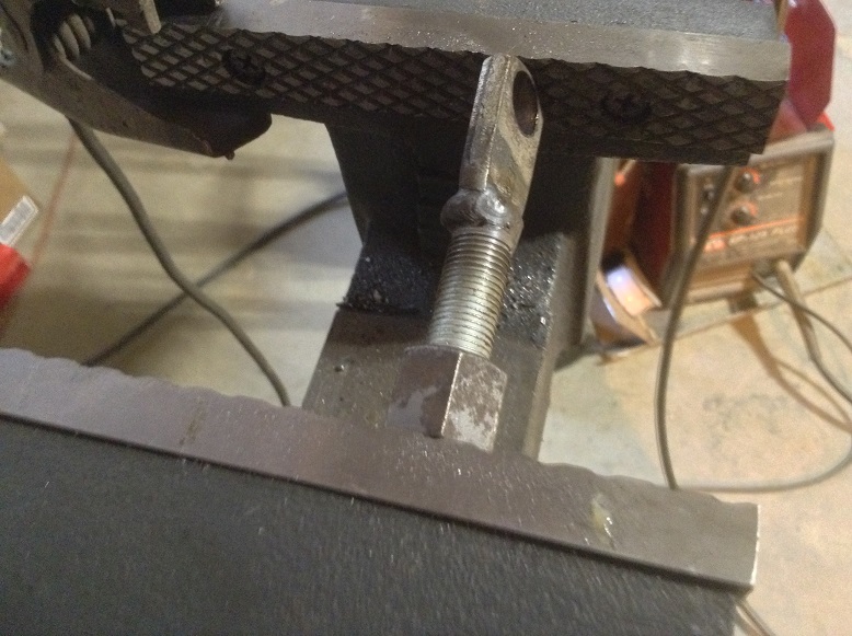

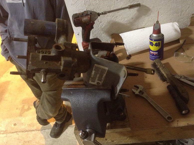

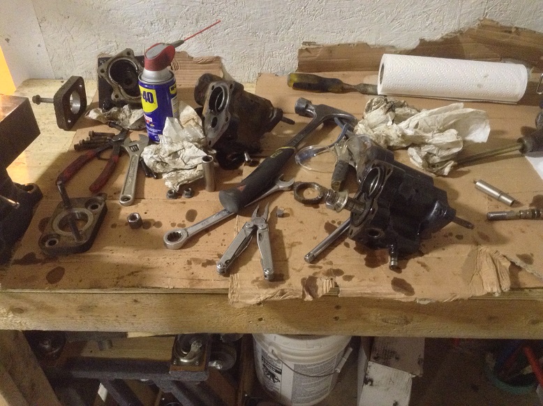

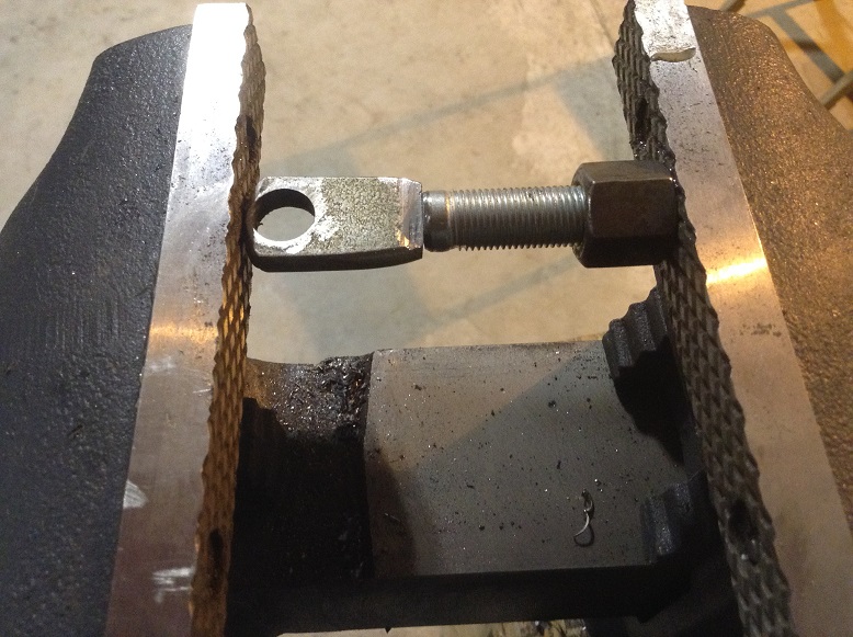

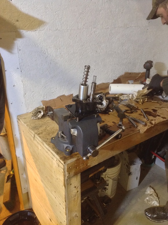

The first round of pictures are of the Hydro boost mods.
I cut down a threaded bolt and the stub of the hydro boost rod and welded them together. I did this so we could use a nut to attach it to the threaded rod on the hydro boost that was existing on the RC when I got it. After starting it up and trying the brakes I discovered that the brakes went to the floor and they stayed there.
We discovered after taking it apart that after the PO did his work on the hydro boost unit, he did not re-assemble it with a return spring or the push rod that goes to the master cylinder. He painted it up nicely but didn't remember to install very key parts... This made it push to the floor and lock up. We dis-assembled a spare hydro boost unit I had on the shelf and we mix and matched parts and re assemble it all to save the day...more like night.
Then there are some pre fender install pictures and one of the custom bent up mid shifter stub for the pistol grip.
