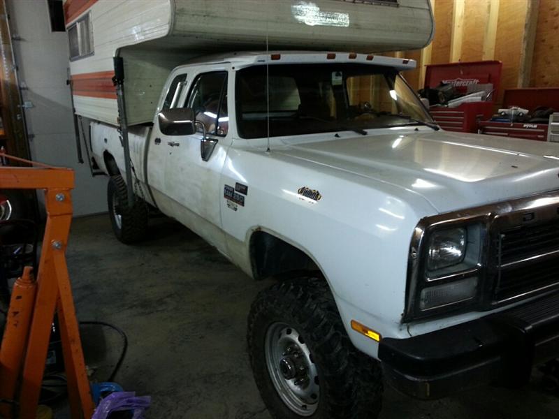

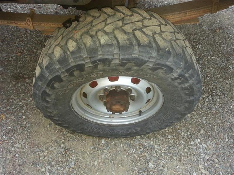

Old Jul 19, 2014 | 12:41 PM
  #59
u2slow's Avatar
Posts: 1,860
Likes: 425
From: BC
I combined a Dana 80 SRW swap with the 3rd-gen wheels. With 2" spacers on the front, and no rear spacers it lines up real good
Attached Thumbnails 3rd Gen wheels: Everything you need to know-camperlift1-medium-.jpg   3rd Gen wheels: Everything you need to know-wheel_3rdgen_on_d80srw.jpg
Old Jul 25, 2014 | 04:24 PM
  #60
Posts: 7,300
Likes: 2,885
I was thinking of trying just that if I ever swapped a Dana 80 in my White crew to replace the 4.10 geared Dana 60 that is surviving back there right now.
