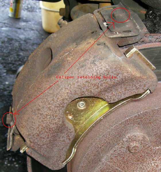

Since I had to do front brakes yesterday I thought I'd take a few pics and explain how the job is done on a 2wd. 4x4's are similar but use a different caliper retaining system. There's also a tip on brake noise that applies to all our trucks.

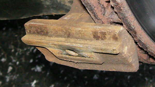

After raising and supporting the vehicle safely (I use 10 ton jack stands under the frame), remove the front wheels. You'll now be looking at something like this:

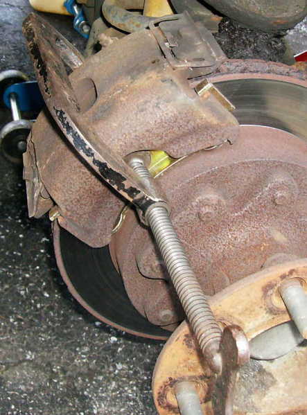

Don't take those bolts out yet! First grab your big "C" clamp and compress the caliper.
This step makes it easier to put the caliper back on with the new pads. If you don't have a "C" clamp that's big enough, you can use a smaller clamp and one of the old brake pads to push the piston in once the caliper is removed.

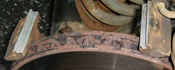

OK, now that the caliper is compressed, remove the two retaining bolts and the hold-down clips and set them aside. Now you can lift the caliper out and hang it up or if you are lazy like me set it on the upper ball joint (being careful not to knock it off). Get the old pads out of the way. Now pick up that wire brush and go after all the sliding surfaces, both on the caliper mount and the caliper itself.
I want them shiny! OK, smooth and free of loose rust and crud is acceptable.

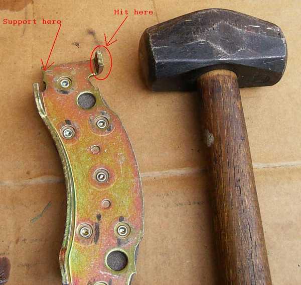

Here's the brake noise tip I mentioned. The outer pad has "ears" at each end and a flange in the middle. When you pull them out of the box, they are a very loose fit on the caliper. This can cause rattles while rolling down the road, as well a squeaks and squeals when stopping. So we need to fit them to the caliper. It's hammer time!
Support the pad on edge using a solid surface and hammer each "ear" down. Give it a whack and try it on the caliper. When it just barely DOESN'T fit anymore, it's right. We want an interference fit here.
Using your channellocks and an old brake pad, press the new pad onto the caliper. Sorry for no pic of this, but I only have two hands and was working alone.

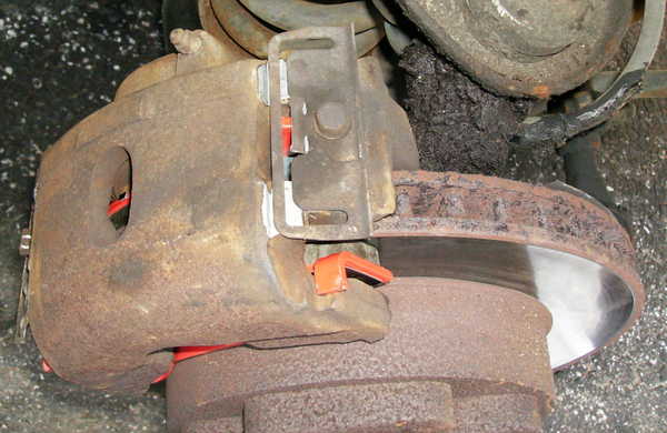

Now take your anti-seize and butter up the caliper mount as shown:
Drop the inner pad into place, then set the caliper on the mount and slide it back and forth to distribute the anti-seize compound. Daub a little anti-seize where the retainer clips rub on the caliper, then install the retainers and bolts. Pump the pedal a few times to push the pads against the rotor and you are done.

i would make sure there is no rust on the caliper piston before i pushed it back in, dont want to cut the seals. nice write up.

Yea make sure you get the sliding surfaces shiny!!! and always anti-seez them incase your truck sits for a while or something.

In the front brake hardware kit there are 2 rubber bands.
Anyone know what they are used for?

They wrap around the caliper and caliper mount where the two come together and are supposed to protect the surfaces from contamination. As you can imagine, they do not last long due to the heat in that area. Use 'em if you got 'em, but don't expect them to be there when you take it apart next time.
I'd like to heed the advice in your other recent thread about applying anti-sieze every time the oil is changed. How is the caliper retaining system different on my 4x4?

BC847 did an awesome writeup that covers 4X4 front brakes.
https://www.dieseltruckresource.com/....html?t=143024
You don't need to remove the rotor to maintain the caliper slides.
It's in the sticky.

Another thing I would do in addition is when compressing the caliper, I would put a hose on the bleeder to a bottle, and crack the bleeder while compressing. This way you don't shove the old cruddy fluid back into the system and possibly overflow the reservoir. Then when finished fill reservoir back up with new fluid.

Many different vehicles have those "tabs" on the brake-pads, the ones Faith shows being re-shaped with a hammer.
What I have always done is to put the pad onto the caliper where it goes, then CLINCH the tabs tightly onto the caliper with a large pair of Channel-Locks, just like clinching horse-shoe nails.
Nobody ever told me to do this, it just sort of looked like that might be what was meant.

Dave, another thing I would caution people to do, for cheap insurance ($7-$10), is replace the retainer clips. Mine had broken, giving me a thump while applying brakes in reverse and a loud clunking noise when hitting ANY imperfection on the road. Drove me NUTS! I thought it was the bad shocks. Turned out the part of the clip that is thin and goes over the caliper should be ON IT! Both side they were broken right where it met with the bigger part on the clip. The tops of the calipers and the inside of the wheels now have about 1/16" less material...
