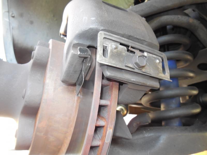

Originally Posted by turnocks
whare do anti rattle clips go
Raybestos H5218 Disc Brake Anti-Rattle Clip : Amazon.com : Automotive Raybestos H5218 Disc Brake Anti-Rattle Clip : Amazon.com : Automotive
I have found these specified for our 2WD front brakes in more than one auto-parts source and have yet to see any pictures or explanation as to where they go or how they should be installed.
Can someone please enlighten us ??
Thanks for reading.
Old Nov 1, 2013 | 03:30 AM
Jim Lane's Avatar
Posts: 4,084
Likes: 235
From: Southern California
Here you go,
You have been enlightened.
The end of the clip holds tension against the edge of the inboard pad.

Thank you, Mr. Jim Lane; picture appreciated.
