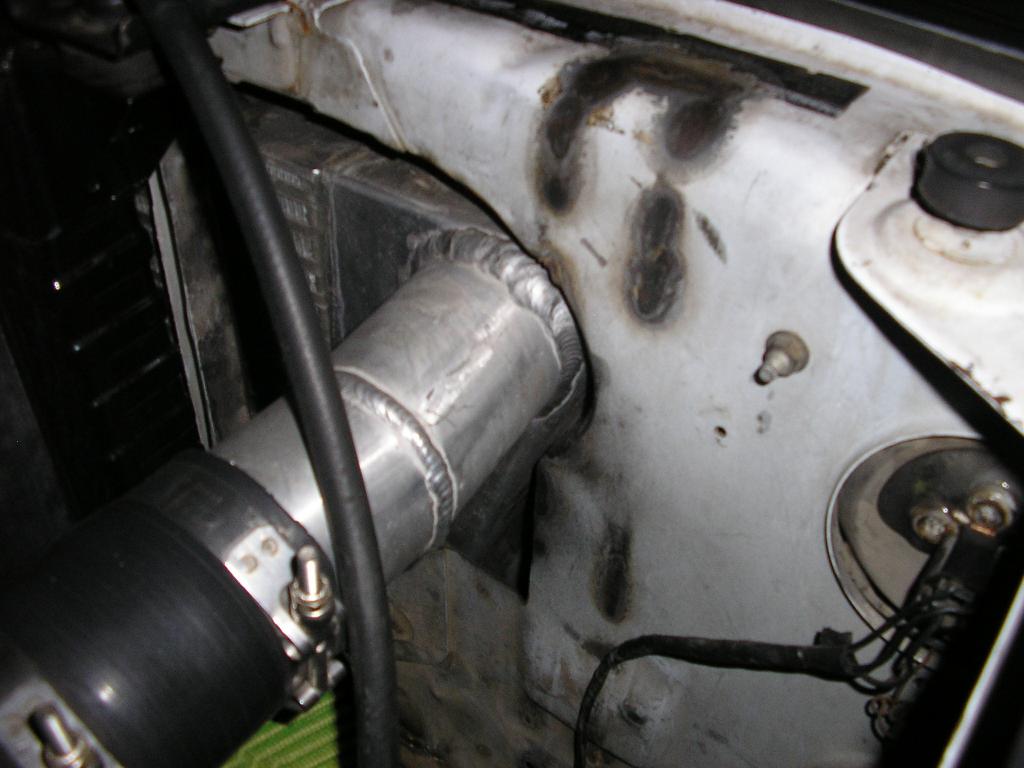

This is a HTT 2nd gen intercooler mounted the same way in my '92.
RonA
