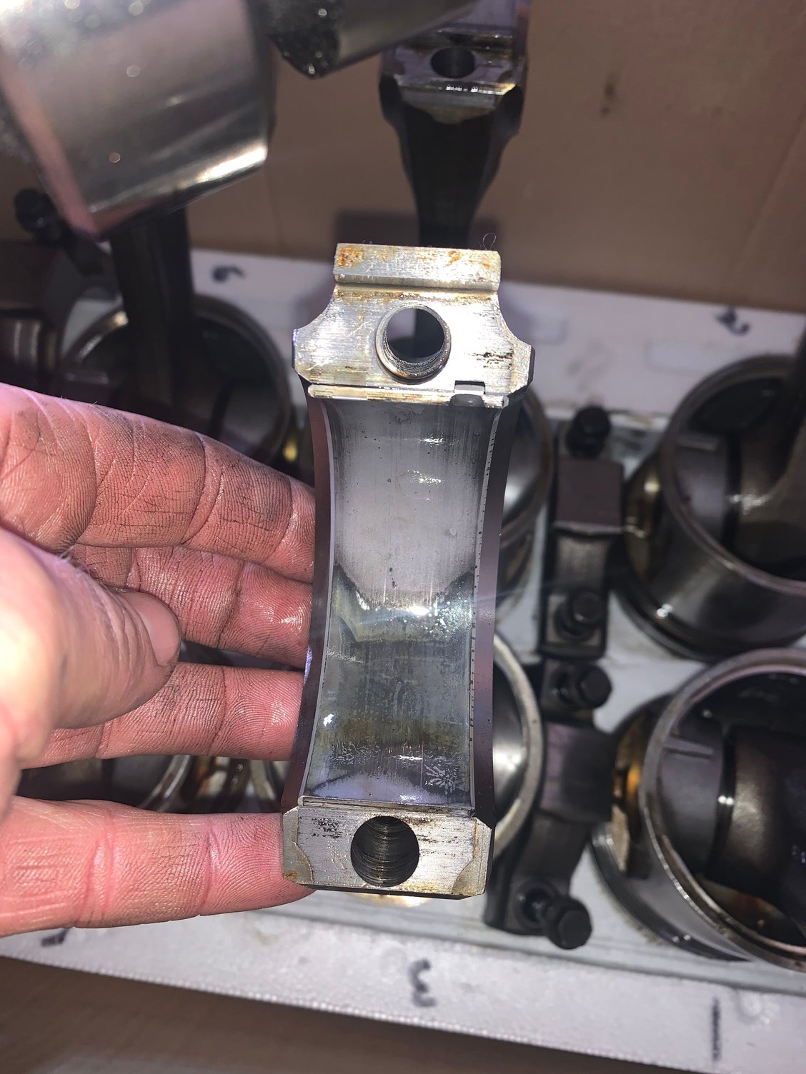

Well I have the time so I figured I may as well just rebuild the thing. Will put new bearings in, deglaze them cylinder walls and install new rings. Am glad I decided to do it, since it looks like there may have been an oiling issue at some point because the rod bearings are showing signs. Could not get the mains off yet, have to go get a 23mm socket, my impact kit decided to skip that socket.
Now here is something that may make a few people cringe, so let me explain. Am setting the engine back in frame 6”, and the only way I found I could do this was to mount the engine conversion mounts further forward, to do that the oil drain casting had to go.
I stewed on this for a couple months and decided this was the easiest way, and it has now had the side effect of encouraging me to do a full rebuild, minus new pistons, since I will now have to take the bare block to someone with experience welding cast iron. There is a really nice little pocket for a thick plate to be welding in, and if done right this spot will be stronger than it was.

Rod bearings not looking great, not sure what the round spots are telling me in a couple of them that came out.

The spots on the rod bearings are probably matching the oil tubes drilled through the crankshaft. It probably sat for a long time with very dirty acidic oil which caused the spots. Sometimes these engines take a lot of abuse.

That makes sense, as this engine was sitting for a very long time.

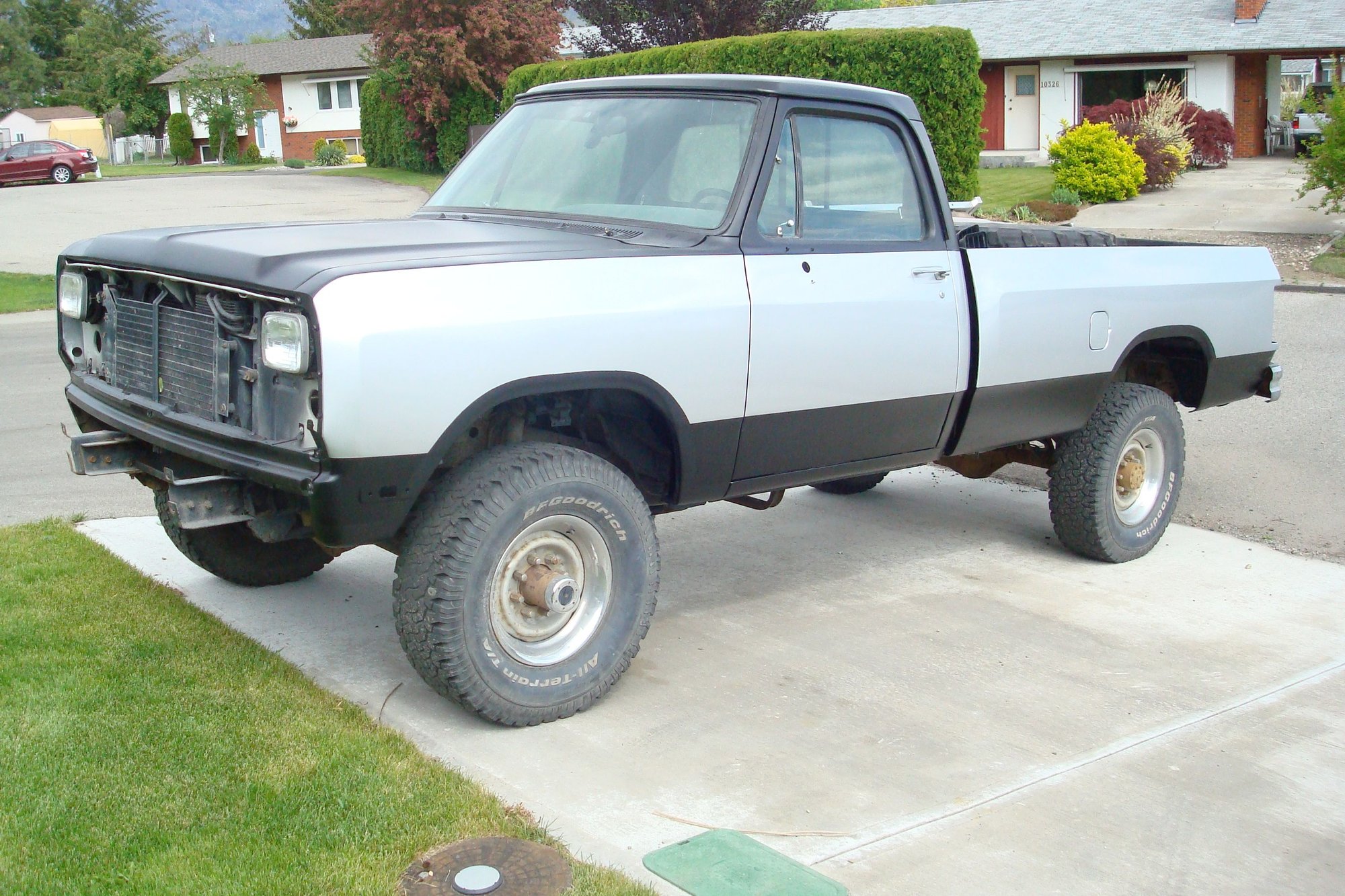

Found some old pictures of a build on DTR from long ago, unfortunately photobucket has long since deleted the pictures in that old thread, was trying to recover my old account to see if they were still there, to no avail.
Only one I could find with the bumper
This new build will most likely use the same colour combination, but will have the 89 front grill.
