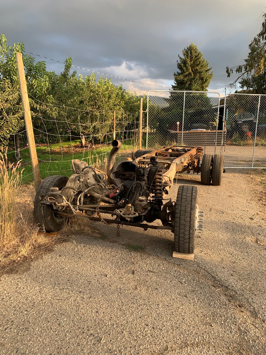

Working with what I got, and starting to make some headway. Don’t mind the mess 😅

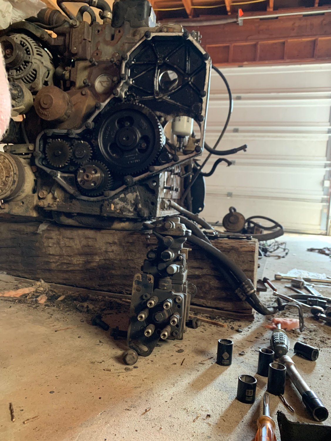

Ip is off, and will have injectors out tomorrow so they can be sent to Giles for a 300hp pump build, and 20% over extrude honed injectors.
Got the adapter in from Wildhorse, choose this adapter because of the steel construction. Just test fitting it, the engine will be completely cleaned and painted within the next couple weeks.
Engine mounts from destroked will be here in a couple weeks too, and after some funds are available again, the clutch and flywheel will be here shortly after.
In the mean time I will soon begin stripping down the F550, salvaging what I need and selling the rest. Will use as much as I can aside from the engine, such as the radiator, intercooler, fan and shroud, ac condenser, brake and clutch pedal assembly, brake booster and clutch master cylinder. Body will be parted out completely. May use the seats too.
Once it is down to bare frame all the parts should be in, and engine put back together so that I can nestle the Cummins into it’s new home. The goal is to have it moving before snow flies.

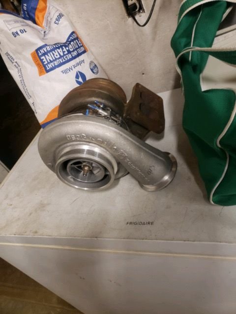

Pump and injectors are on their way to Giles, am having him replace the nozzles as well flow honed 20% over and re popped. Engine mounts are in, and I just picked up an s475 for the compound set up.
Once dieselpowersource has hot pipes back in stock for the he351cw to the s475, will get it down here so I can start mocking up the compounds. In the mean time just parting out the F550.

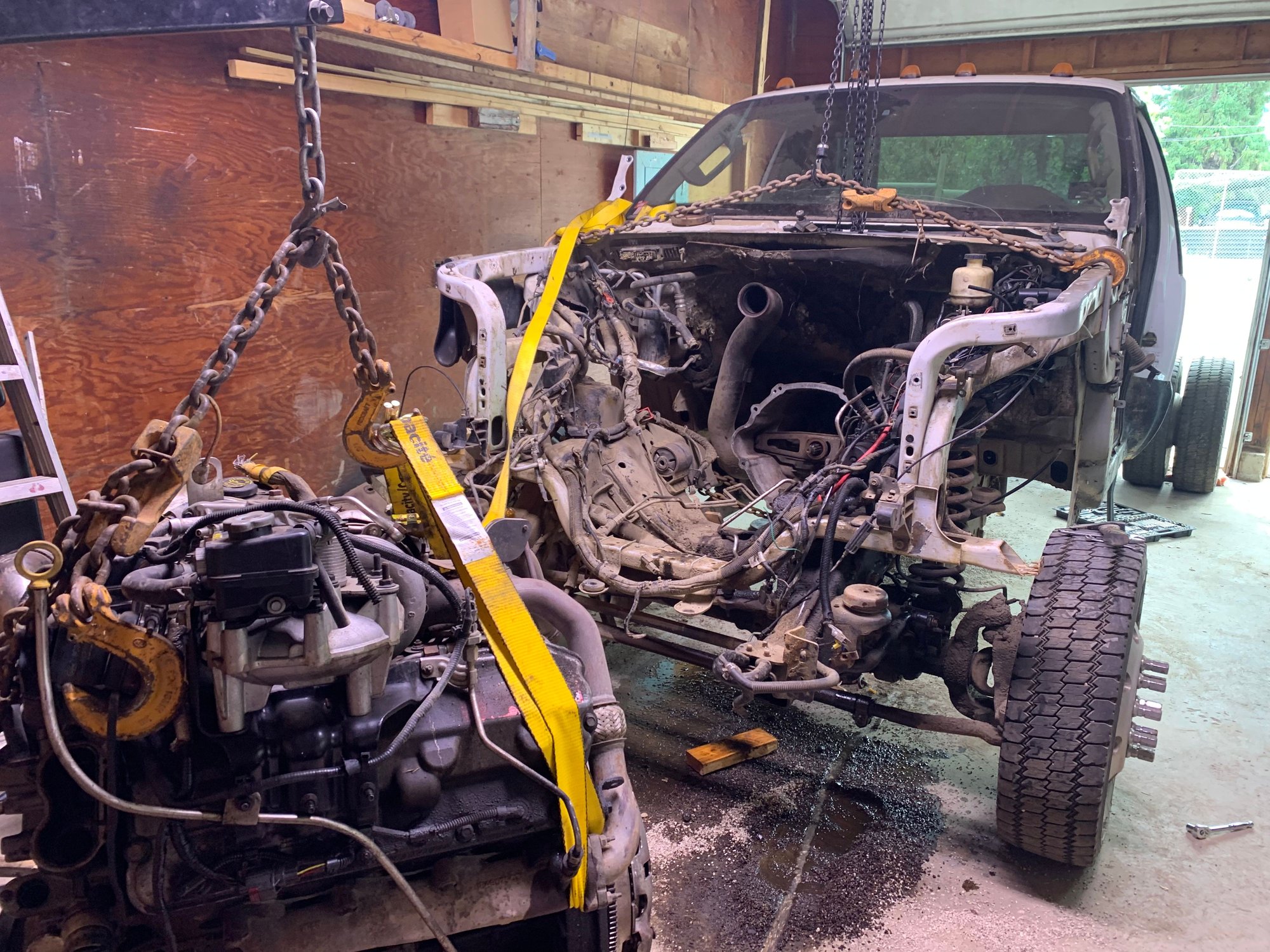

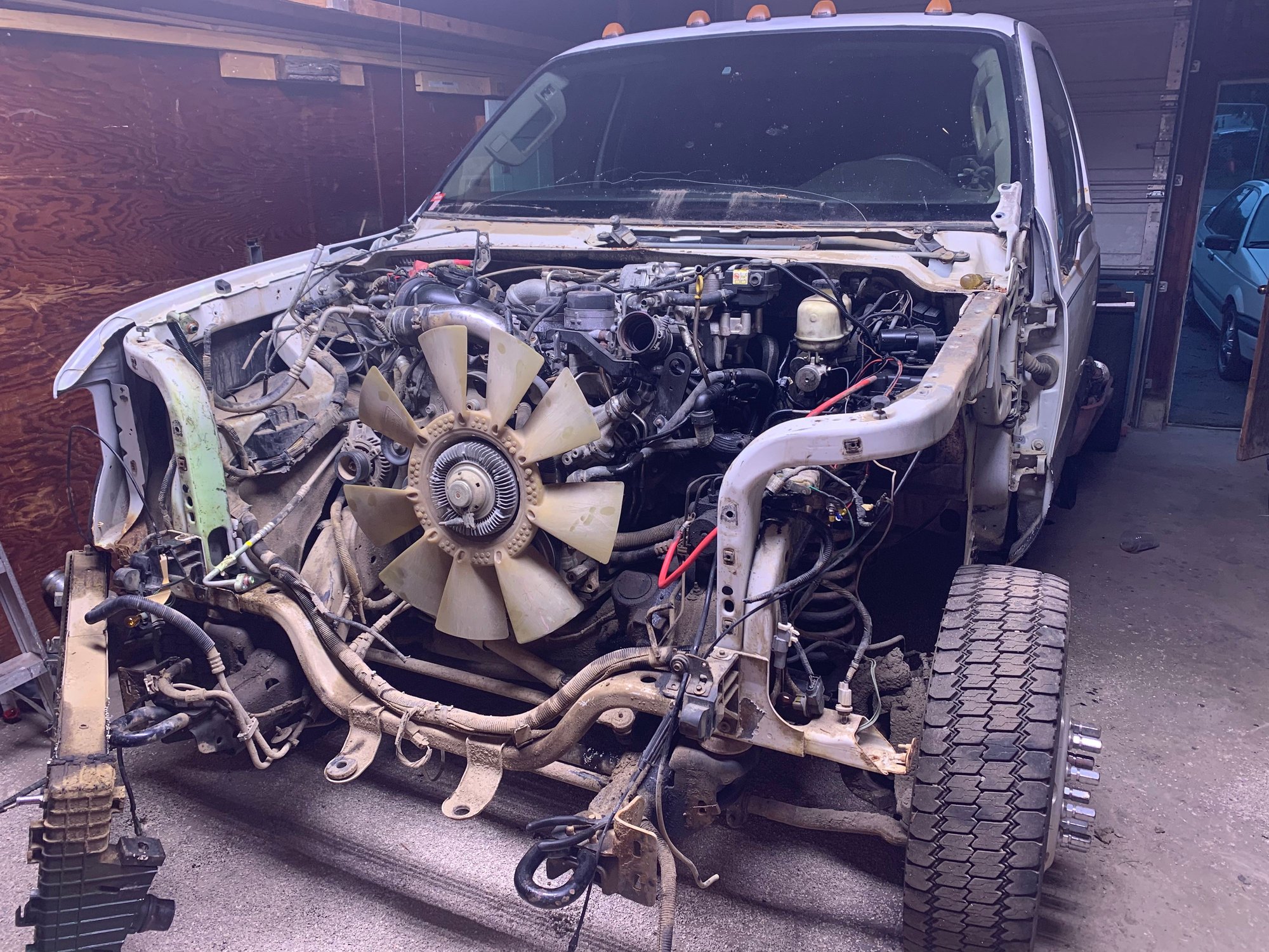

A little redneck but getting it done.
My rear picking mount for the come along broke. Luckily I got the chassis out and was far away when the body dropped.

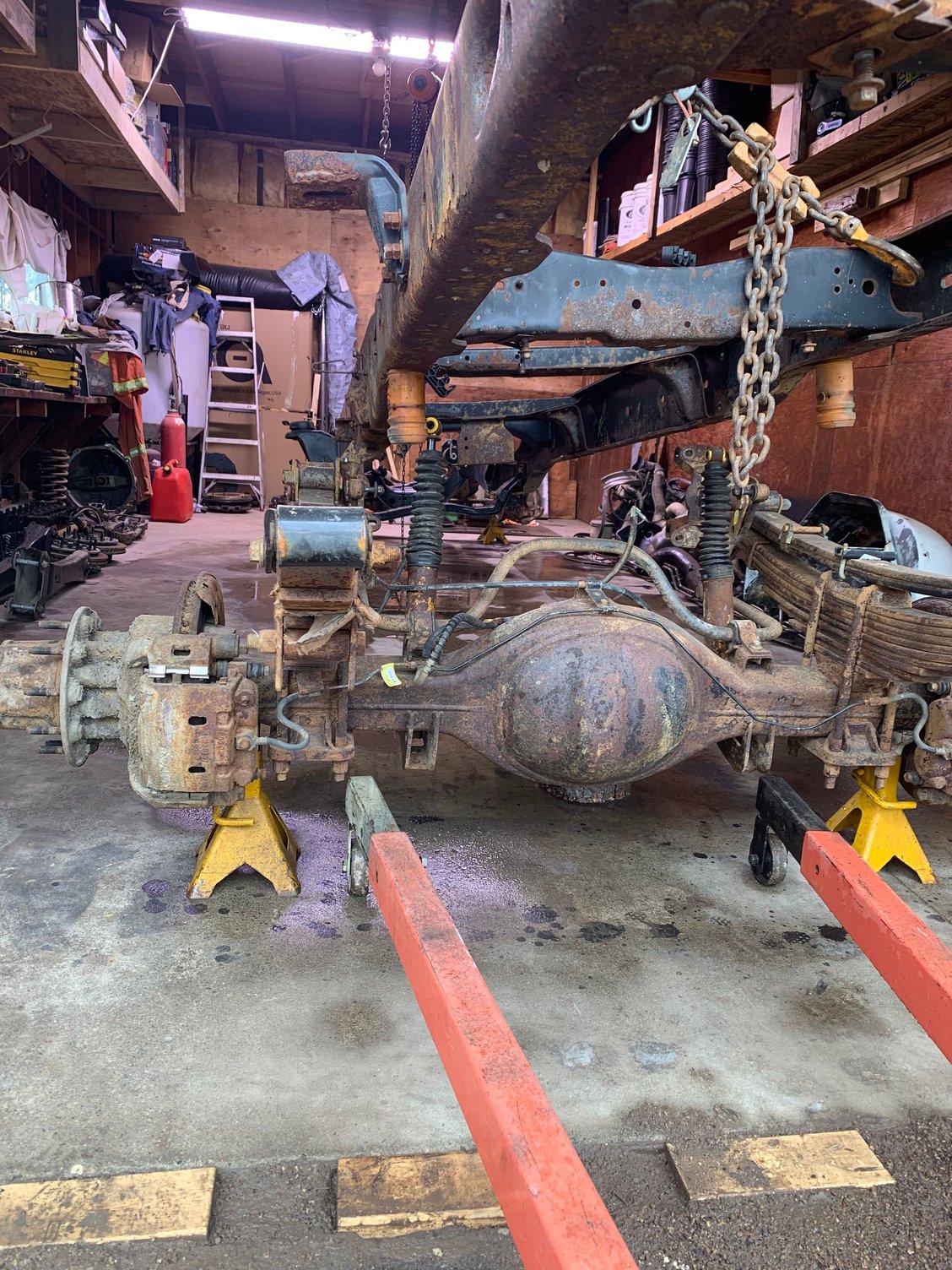

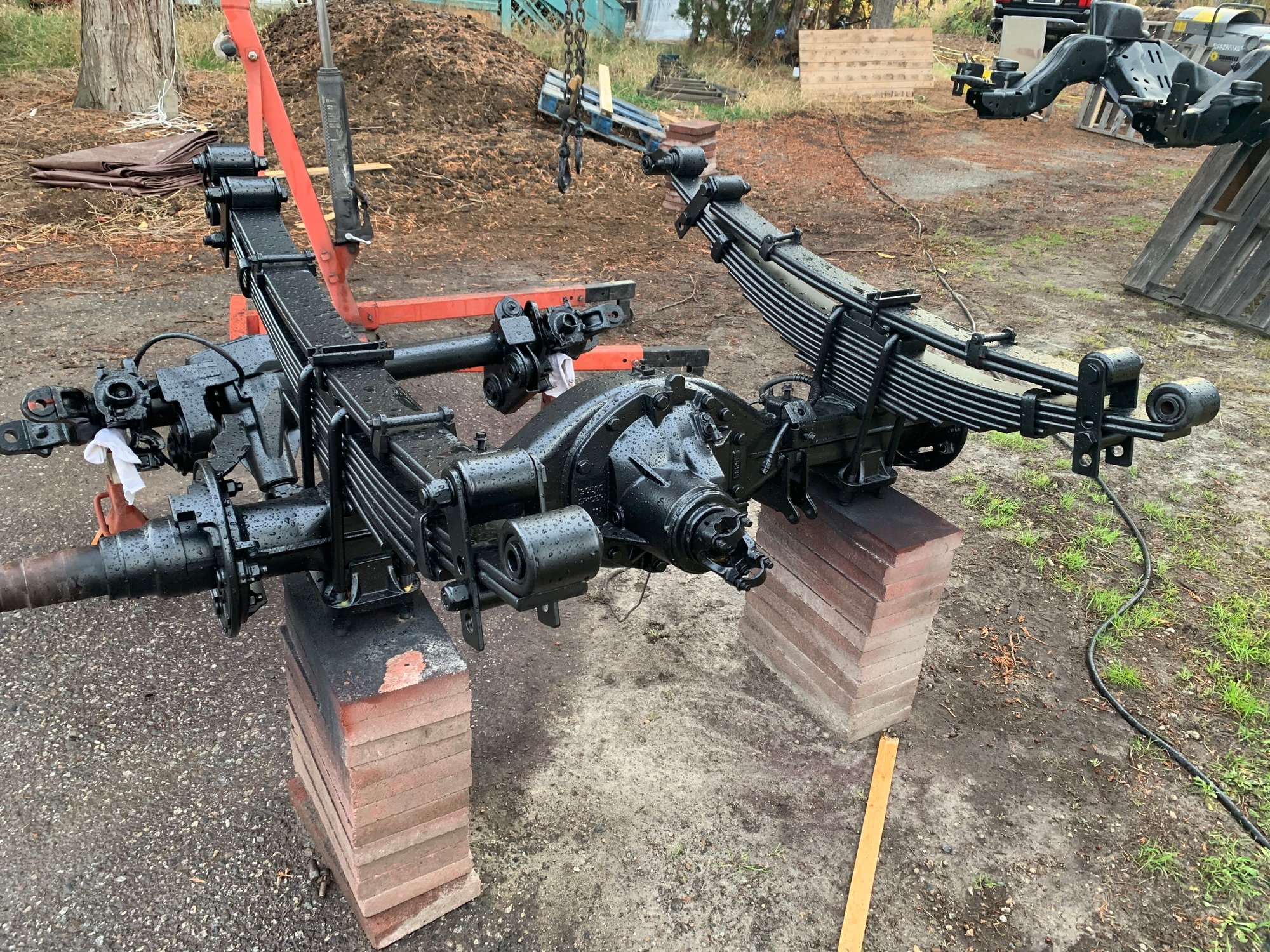

Pressure washing time. Which ultimately led to my decision to have the whole frame, axles, suspension and steering parts sand blasted and re-painted.

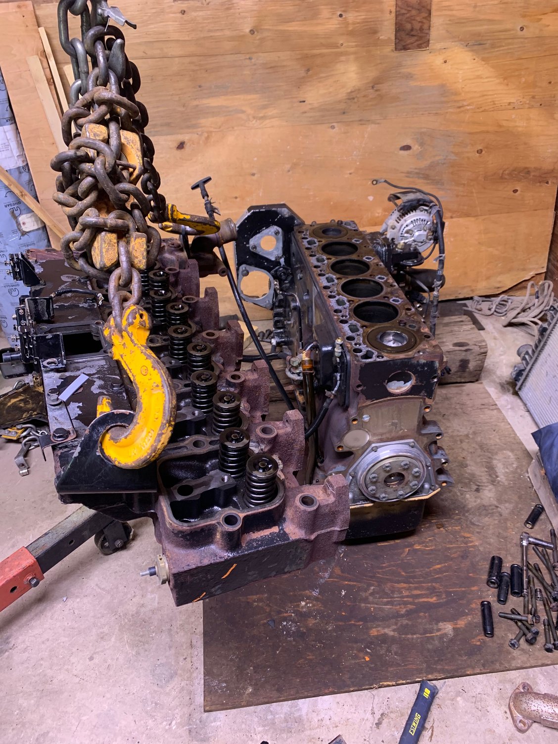

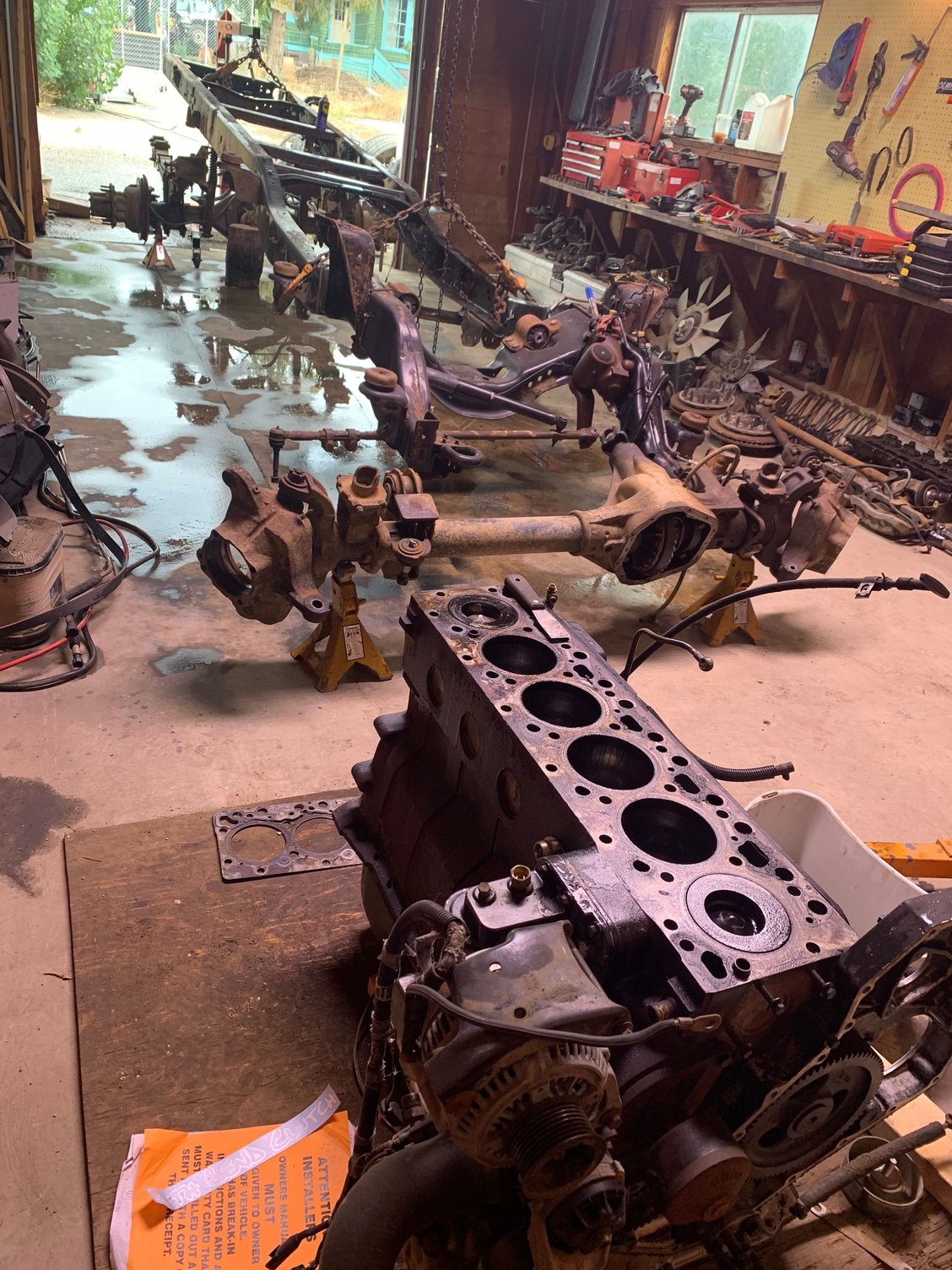

Head off and sent to the machine shop tomorrow for fire rings. Head studs should be here end of the week.

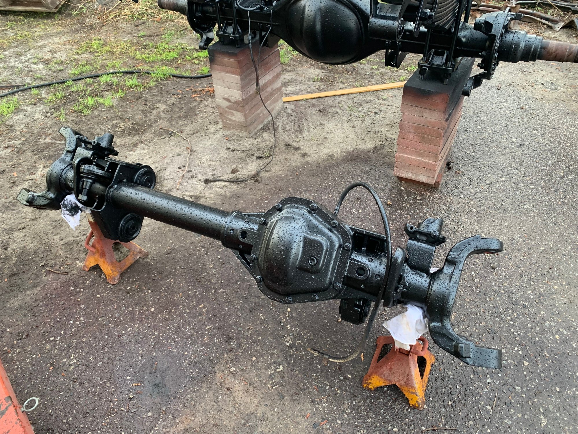

Removing rear axle for blasting.
Collection
And front axle for blasting
Will be doing new brakes all around too.

Man that was a LOT of crap stuffed between the fenders, around that motor & under the hood!!! Once the Cummins is in there you'll have room to serve tea!
Looks like most of the hard, dirty work is done (well, after sandblasting anyway...), so you're at a milestone.
Got lucky with the cab fail! Much damage or were you trying to salvage it anyway? And better upgrade that little yellow hook on the motor too, it looks a bit small and could fail too...
How did those piston bowls and cylinder walls look?

Am glad that there was not a lot on the ford that I wanted to salvage, it allowed me to just cut and tear stuff out which made the process a little easier. Part of the reason why I want the older body style of the dodge is just for this exact reason, engine space. Aside from the also obvious reason of my love of the 1st look and the sheer simplicity.
Am still shaking my head, too many close call lessons in life from cutting corners, and apparently the lesson has still not completely stuck. The yellow hook is actually a rated lifting hook, rated for far more than what I am lifting.
Was told this engine had 180,000km when pulled, and it definitely looks to be true, aside from some carbon build up on a couple valves, everything looked mint.

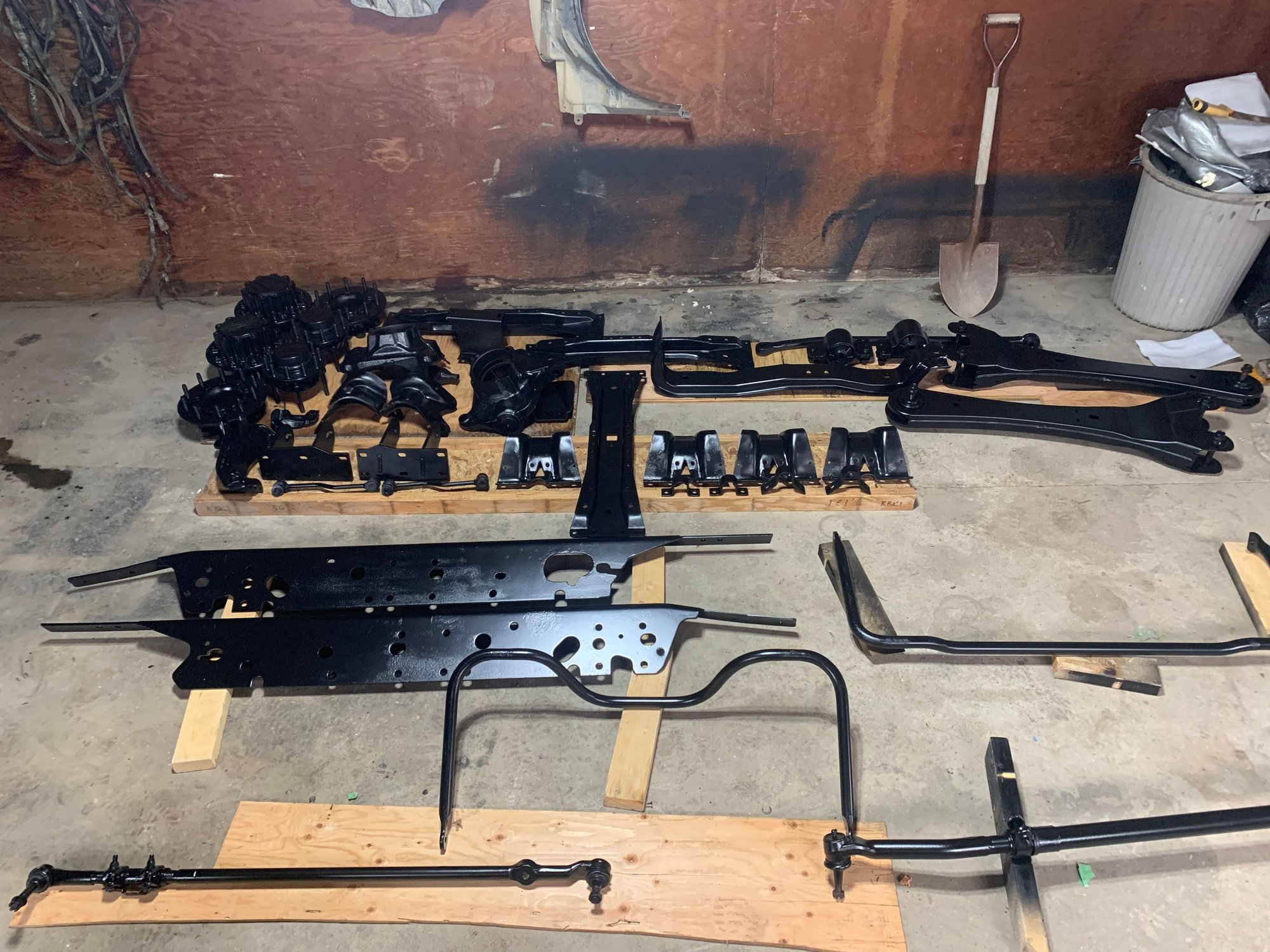

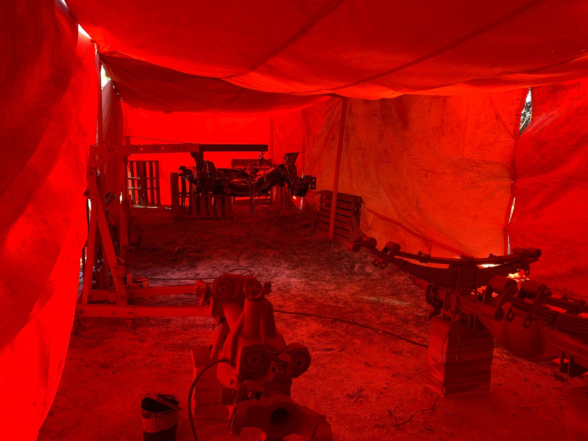

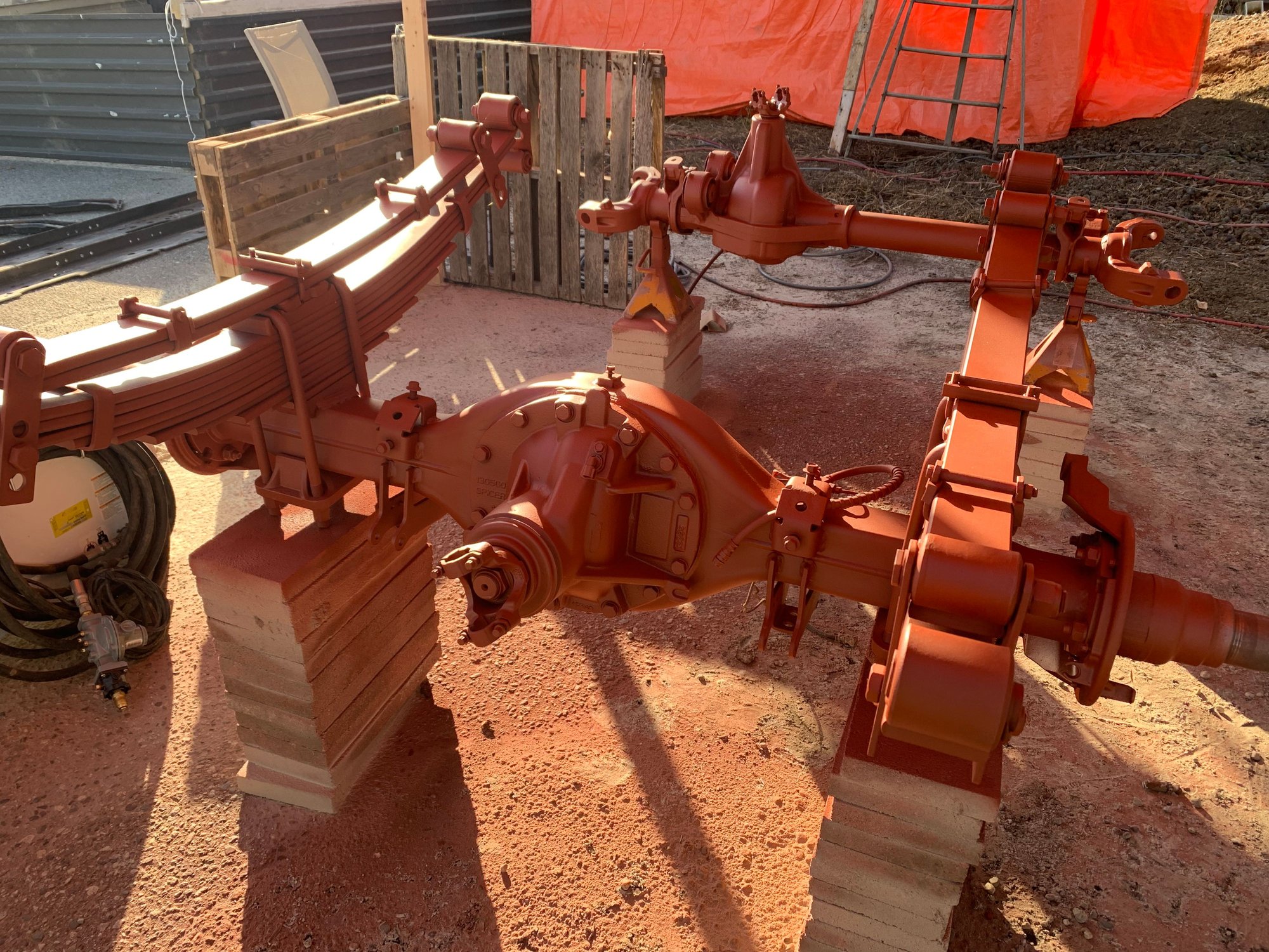

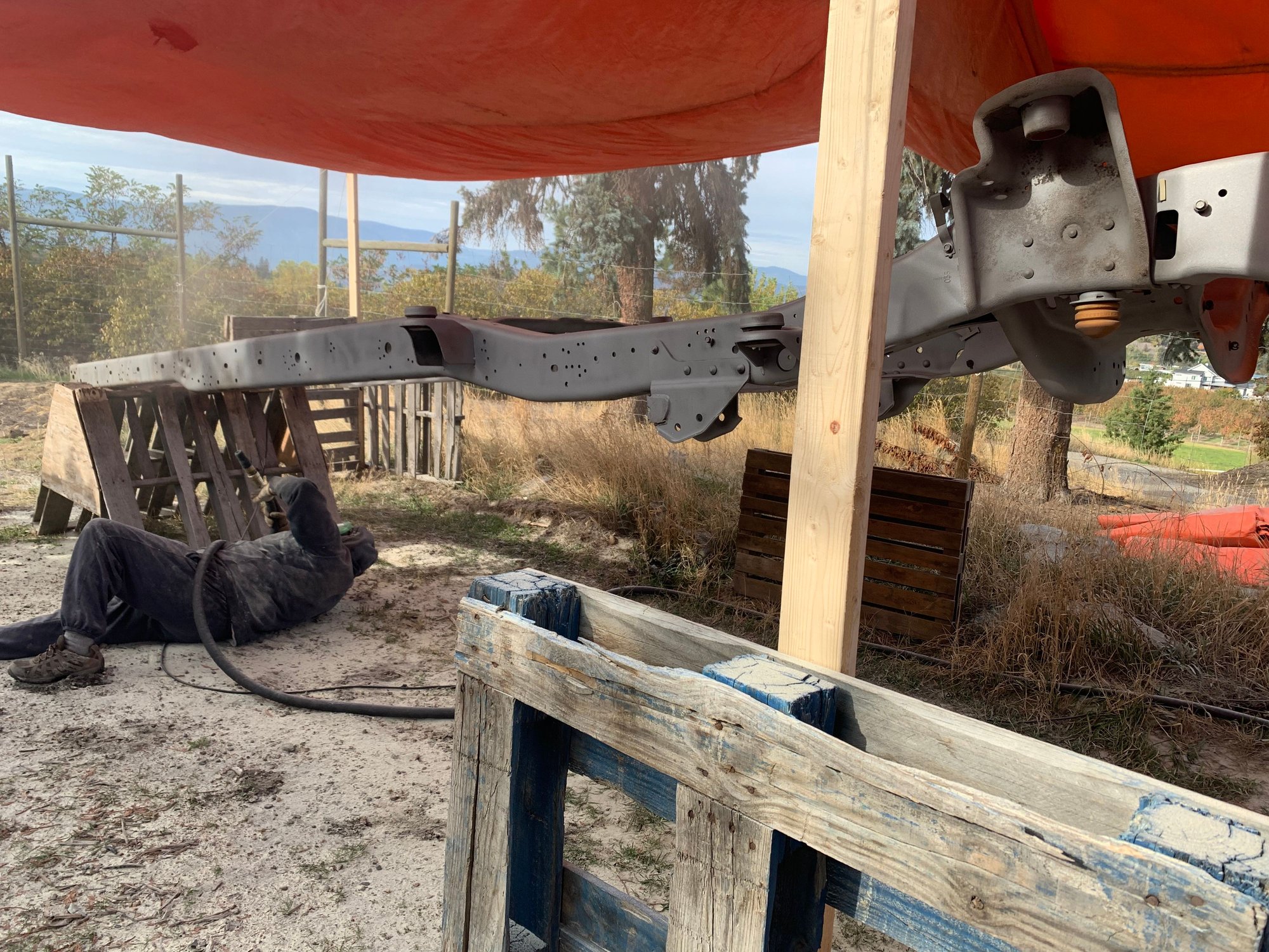

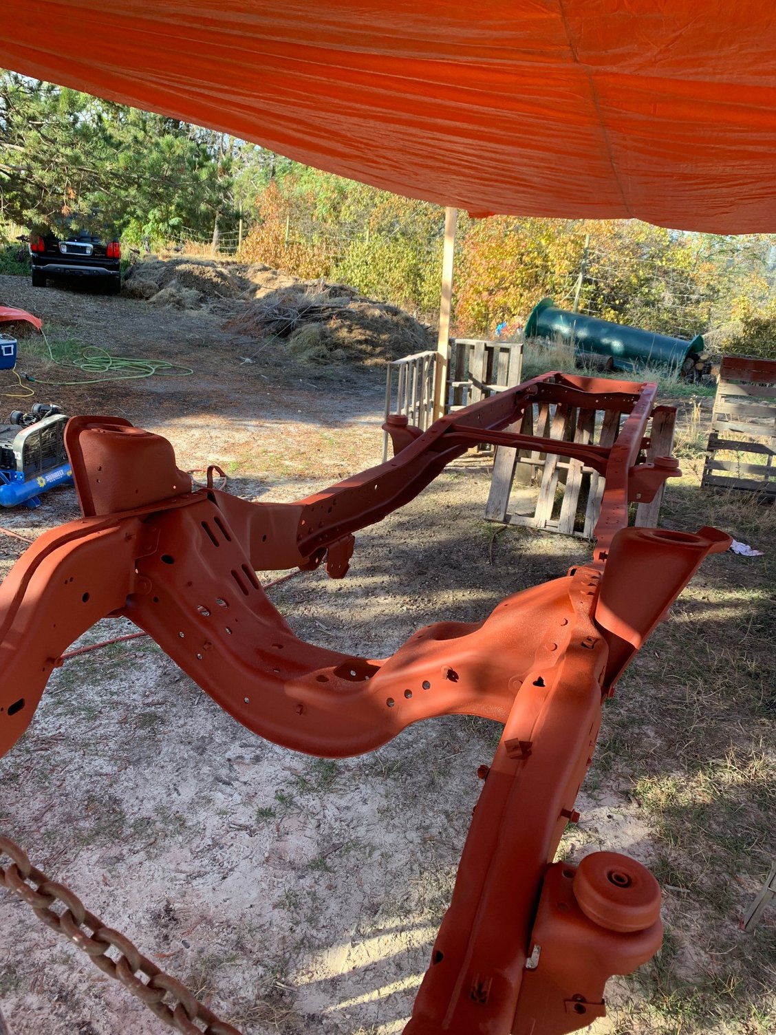

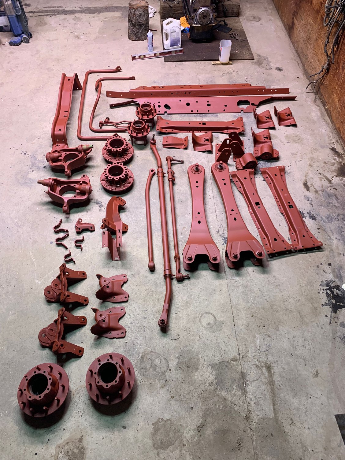

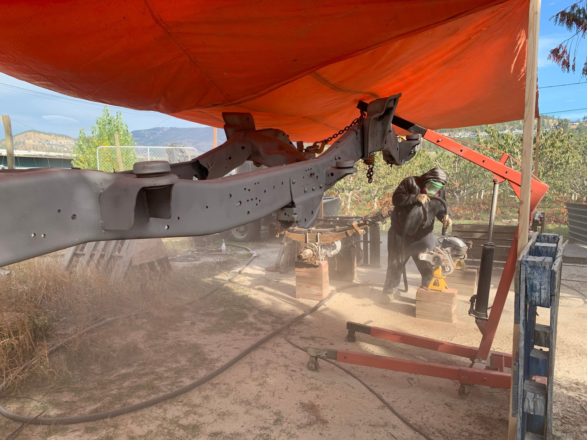

A friend came with his industrial blaster and did the frame and axles, afterwards I sprayed everything with a rust enamel primer than polyamide epoxy.
Tomorrow I will be blasting and painting the rest of the steering, suspension and crossmember pieces, so I can finally begin putting the pieces back together.
Just have to press some new ball joints into my knuckles and replace the inner and out axle seals, and I can work towards getting this chassis rolling again.

Blasted and primed, finish coat sometime this week.

Everything painted and got my head back from the machine shop with o-rings.
