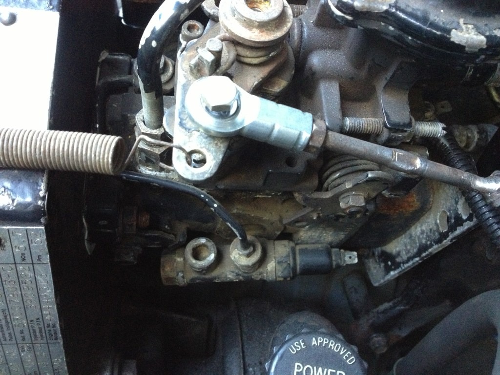

Since I have had it I added a boost gauge, and did the linkage mod to move it to the inner hole. This made a HUGE difference as I definately wasnt getting full throttle travel. this was most noticable in the passing people on the highway punch, and also in my boost, before I could punch it at like 60 and boost would top at like 17, now it will get to over 25-30 psi almost immediately and I have yet to really punch it cause i think it would go past that into the 30s and I fear my wastegate may not be functioning properly.
I have no idea where my fuel or power or starwheel settings currently are, but I can tell they have all been messed with. Only thing I have done is bring the T-25 screw back out 1 full turn because it looks to me to have been in all the way in reference to the lock nut. I did this because I thought it would help with what I call high revs that take a while to come back down to normal idle when I let off the pedal. The springs, linkage and return spring all seem fine so I dont think its that but it will just take way too long I think to idle down when coming off a load, and even in just normal 3rd-4th-5th shifting under easy acceleration. Any comments on this..? I dont have a stock 1st gen to compare to, but it seems like the rpms stay high way to long. If I just sit there not under power and blip the throttle they come down nice.

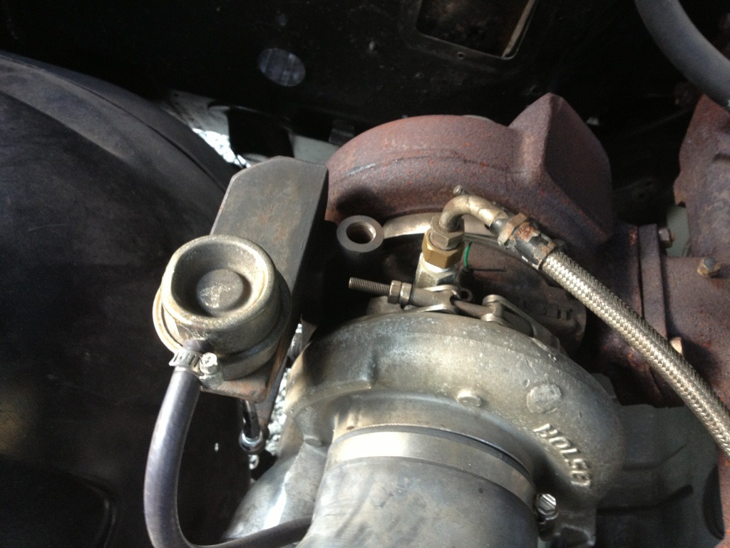

In the one picture with the oil line for the turbo side of the line, to the left of that line, I have an open threaded hole. Some research shows another one with this hole unplugged....what is that hole for and should I plug it?
In the picture of the side of the pump, what is the connector for on the thing on the bottom? I have no wire connected to it..to the right, I have the wire that shuts fuel on/off I think thats what that is.

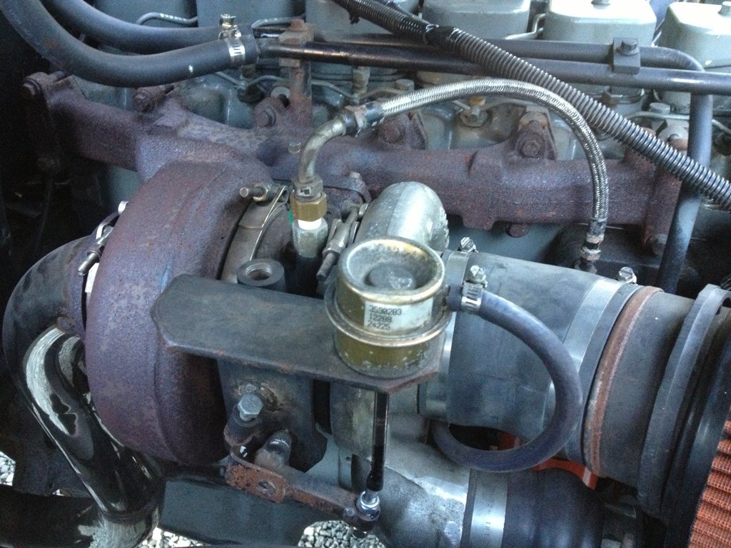

My wastegate is rigged I think. its been mounted in a diff spot and when i got it, it was dangling, no lock nuts, and wasnt attached. I added the lock nuts and welded the rod to allow for lock nuts on both sides...but then in my research I can see barely (no real good pics existed of a stock wastegate because of location in my searches) that a spring exists on the top side...I also seem to have a homemade wastegate stop that limits how far it can release? I am thinking I should have a wastegate on this, I have plenty of power and dont mind letting some go to prevent any overboost problems. I nearly daily drive this truck (and even in winter once I install heat ill drive it some too) and just want relaibility and longevitiy, but also within reason power mods to push these tires. Right now it does drive like a very powerful truck. I can keep up with traffic like in any truck I have driven and am totally hooked on my first cummins. I hauled two cords of wood with it the other day too and no issures there.

In the one picture with the oil line for the turbo side of the line, to the left of that line, I have an open threaded hole. Some research shows another one with this hole unplugged....what is that hole for and should I plug it?I think that's for the wastegate mount, yours looks custom.
In the picture of the side of the pump, what is the connector for on the thing on the bottom? I have no wire connected to it..to the right, I have the wire that shuts fuel on/off I think thats what that is. thats the ksb, it advances timing when it's colder out for easier starts. If you want you can hook a switch up to it to gain more power and use when it's cold out. The other part that has the wire going to it is the FSS, it turns the fuel flow on and off .

That looks like a wastegate actuator controlled HE351VE on there, so that isn't a wastegate per se. Don't be scared to get into the 30's with boost. Being it is a variable turbo, response is going to be near instant, and you will have to push it and see where boost levels off, it isn't going to keep climbing at a steady rate, it will level off as the wastegate actuator opens the housing up.
that port on the turbo is for water. you will find another port on the other side. these are the inlet and outlet ports for water cooling. you should plumb them and run water through it. it was designed for it. water and oil cooled turbos are superior to only oil cooled. see if the sheetmetal badge is still on the turbo, it will have the model number on it. it does appear to be a ve or vgt turbo. with variable venturing exhaust housing

I turned my full throttle screw out 7/8 of a turn last night and it made a big difference on the throttle hanging up between shifts. It wouldnt idle at all after that (expected to be lower I read) so I brought the idle up for now.
During highway run this am, i now seem to be topping out at about 25-27 psi during most punches although with traffic I can say I really didnt do a full out drag run. I now see what you mean about the turbo not just climbing climbing, and also maybe the full throttle screw had something to do with it.
Ill check out that tag tonight and also thanks for the tip on the water cooling ill look for the other port too.

I went from 21 PSI to 32 PSI just by turning my fuel screw in 1 3/4 turns on my stick shift '85 Crew cab.
My EGT was a little high after this, so I turning it back 1/4 of a turn, the temps dropped a bit, and my PSI tops out at 31 now.

Cool M-715, I like it even if it isn't a Dodge. A question for whoever knows; is the wastegate the way to go to control the VGT? I haven't seen that set-up before, but then I haven't been looking for awhile.
