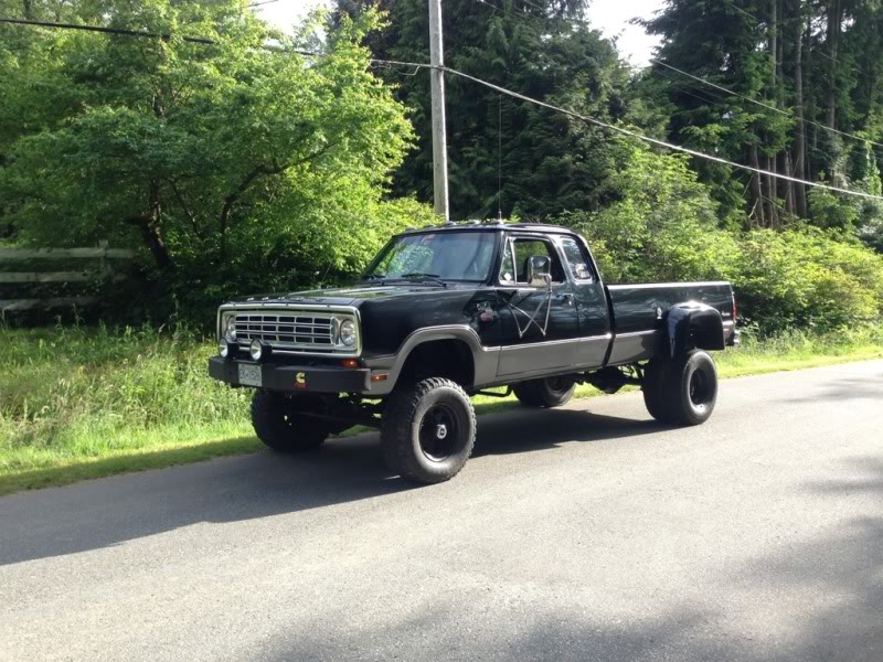

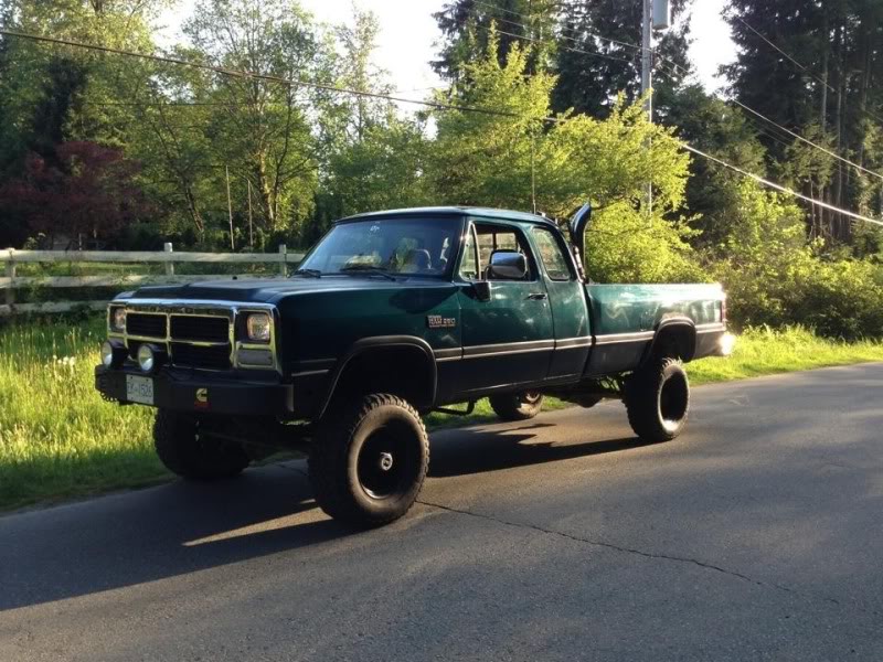

Thanks for the compliments guys! Drove her today.
Old Jun 15, 2013 | 01:17 AM
BDdiesel's Avatar
Joined: Oct 2007
Posts: 110
From: maple ridge BC canada
