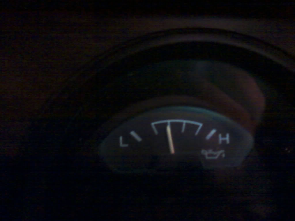

$40 low oil pressure fix
NAPA/Echlin part OP6670- oil pressure sending unit
NAPA/Evercraft 776-9049- 1 1/16 oil pressure sending unit socket for newer GM and Chrysler models
Local NAPA had the sending unit on the shelf. Could probably use a flat wrench to turn it in the block. A regular deep socket isn't deep enough for the sending unit. You can turn this one with a 1/2 inch ratchet or a 1 1/8 wrench.
At idle after cleaning up the pins in the plug
At idle with the new sending unit
I am now showing more pressure just off idle than I had at speed with the old sending unit.

Mine looks the same way but the low pressure dummy light doesn't illuminate. It doesn't take much for it though. If I were to engage the clutch without any throttle, the light would come on for a second until engine RPMs came back up. I'm hoping that it's just the pressure switch and not actual oil pressure dropping that much. I really do need to throw a pressure gauge on the system soon to make sure I'm within specs!

x2 on this fix cept my oil light wasn't going on and the gauge was all the way to the left intermittantly. After the new sensor went in it always stays in the mark furthest to the right in the "OK" zone.
