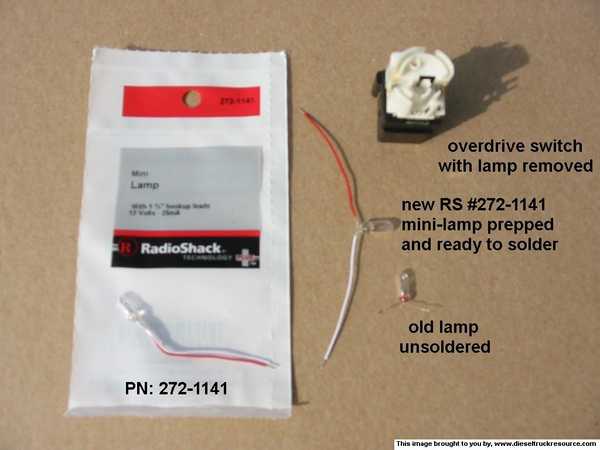

Overdrive Switch Lamp Replacement
Hopefully, one day this may be of benefit to someone...
This is how I replaced the light in my 92 Dodge overdrive switch (same for cargo switch). I used a Radio Shack #272-1141 mini lamp ($1.49). The biggest pain was getting the switch out of the dash. Smaller hands are beneficial here as there isn't much room to work.
Gently open the switch up (you will see the 4 little tabs) to gain access to the lamp. Unsolder the lamp leads and knock off the excess solder. Prep the new lamp by breaking off the plastic around the base. There is also some sort of a plastic-like insulating material around the base that may need to be shaved down (I used an exacto knife). Once you have done this, cut the leads to length and strip the insulation.
Solder it back in and reassemble the switch. You are good to go.
