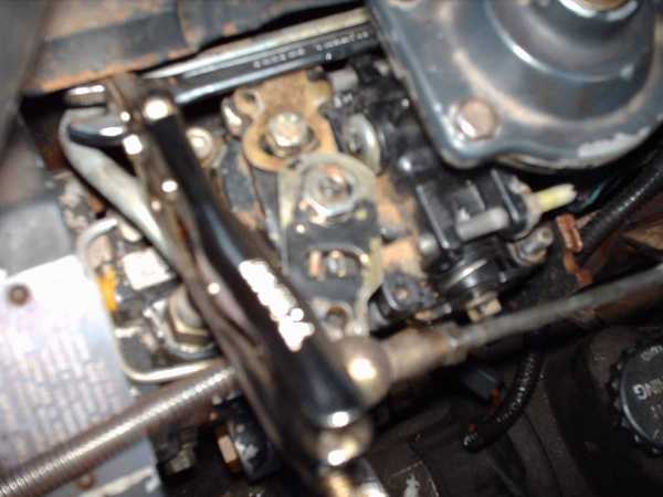

From what's in your signature I bet it's turned up a bit. Set it to idle as slow as you can stand it, it'll start vibrating pretty good around 650 RPM.
You will want a bent wrench to get at the locknut.
It's a cheap 10mm combination wrench heated up and bent to fit. Used like so:
You may find that you can't back the screw out any further because the return line is in the way. This happens on trucks that are turned up a bunch. If this is the case, grind or cut about 3/8" off the accessible end of the screw and then turn the idle speed up as needed.

Idle is now down to an acceptable level.
Took Wannadiesel's advice and bent a 10 mm wrench.
Backed off the idle screw and now I'm not jumping out into the driveway when I place the truck in drive.
