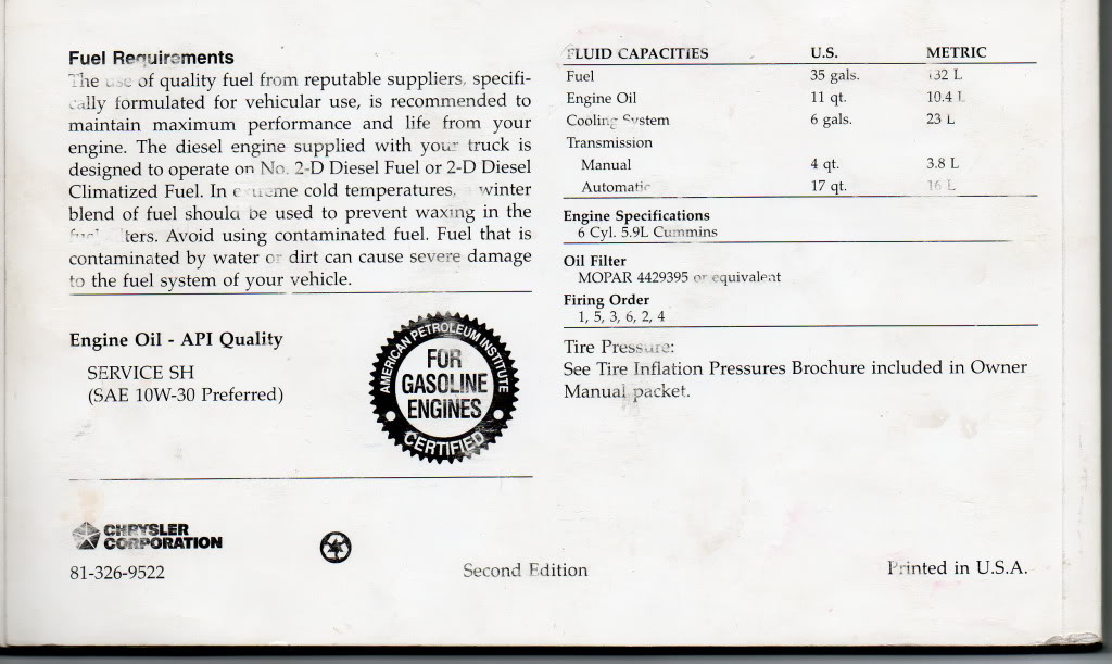

Use standard III, these are older trans with parts dateing back decades! The new thin stuff is for modern light duty rigs. Oh, and the manual is often wrong! Like it saying to use 10w30 oil in the cummins!
