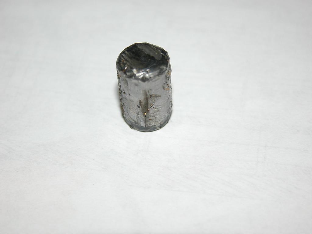

Lookie at what I found!
Checking the oil today, and making sure nothing was moving or leaking, I looked down at the Vacuum/PS pump, sure enough, there she was!
Figured I might as well show Y'all what a pin looks like after it goes thru the gears and case.
I am amazed it did not chip or kill a gear after seeing this thing.
I am thinking about having it Bronzed and hanging it from the mirror.!
