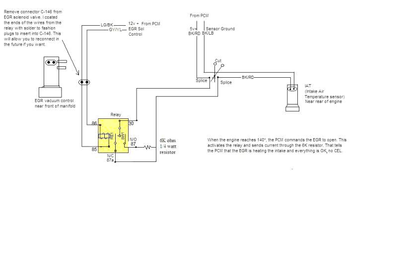

You will need this circuit to "fool" the ECU and avoid a check engine light
You're the man, exactly what I needed.

mine didnt get a check engine light when i took all that stuff off. i took off the egr, put on a HTT manifold and put a stock intake manifold from a 97 that was from CA. man the engine seems so much happier now and it gives me a warm fuzzy not having all that crap on there
