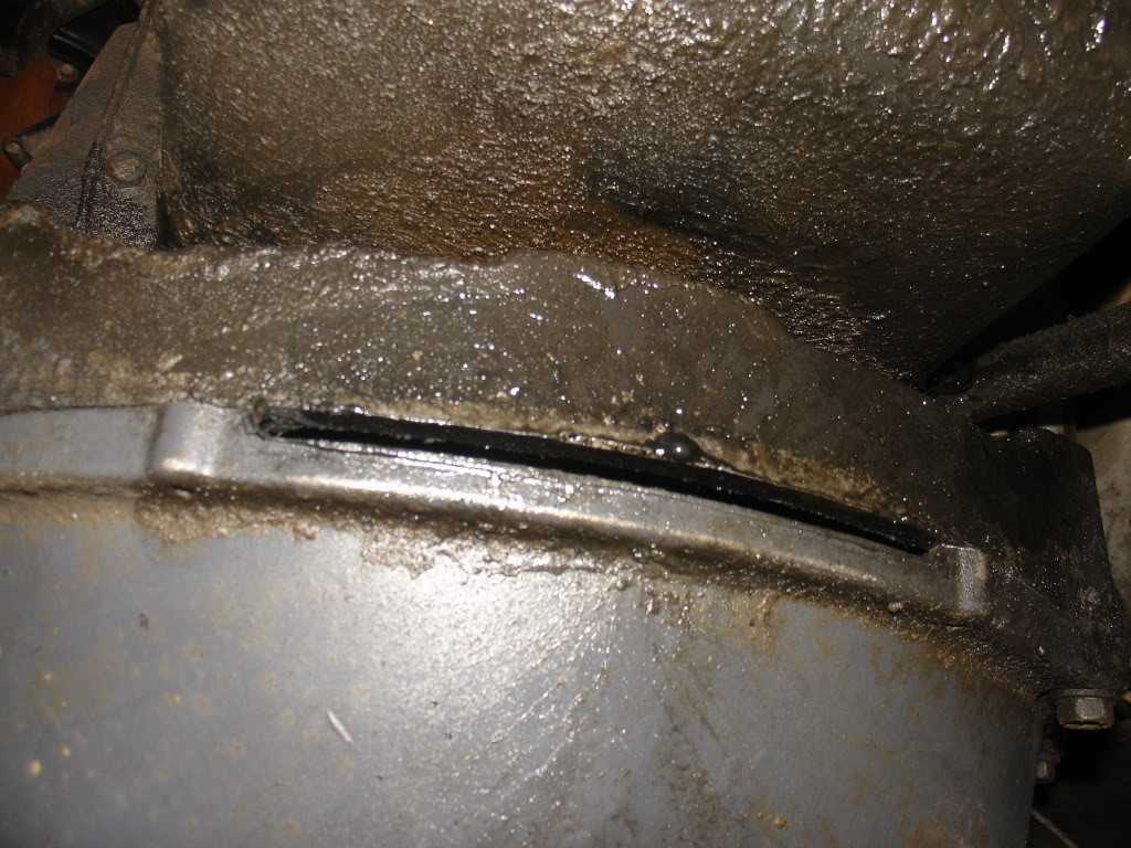

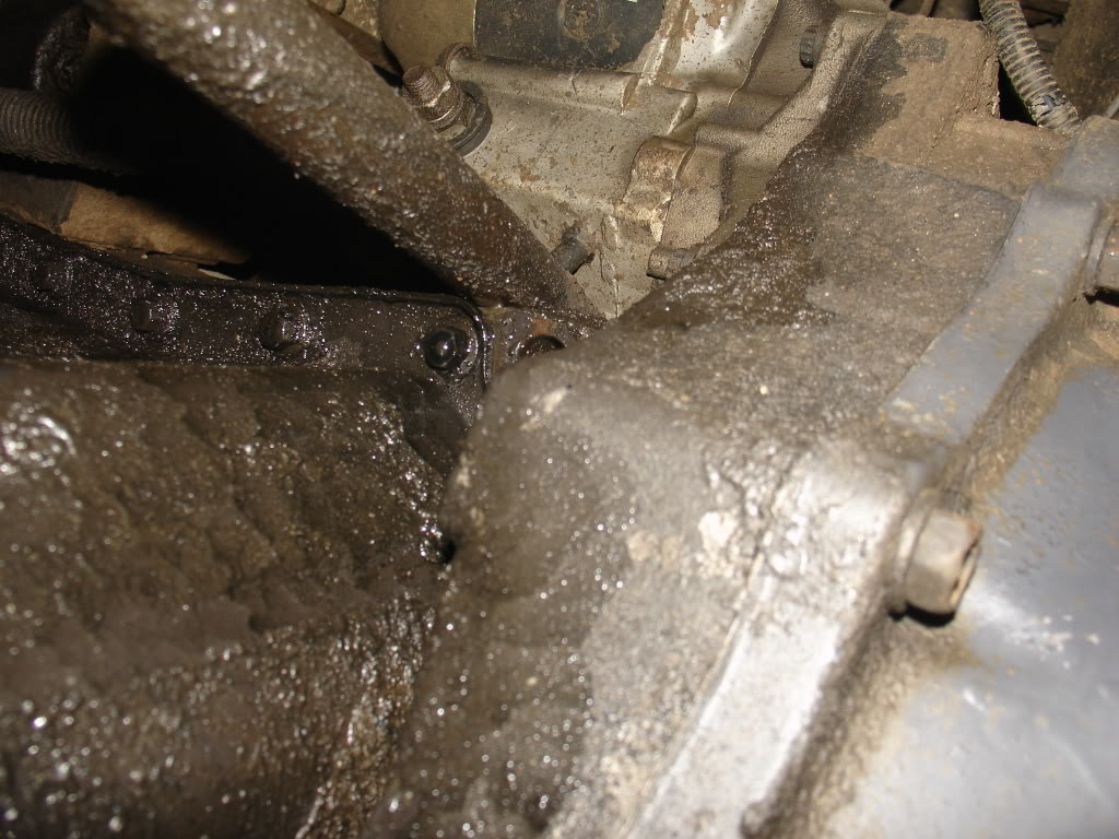

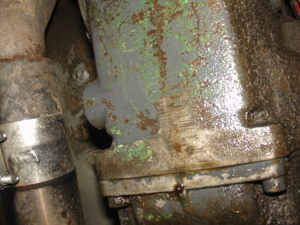

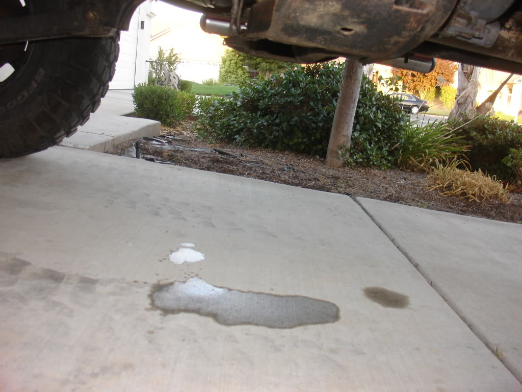

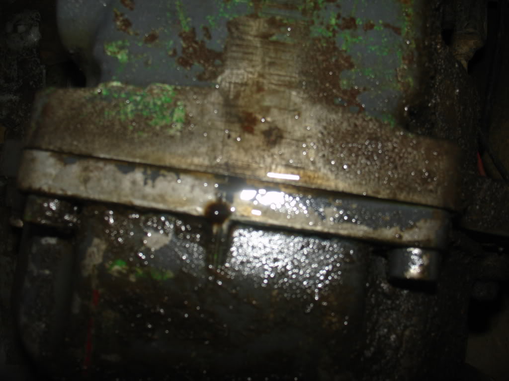

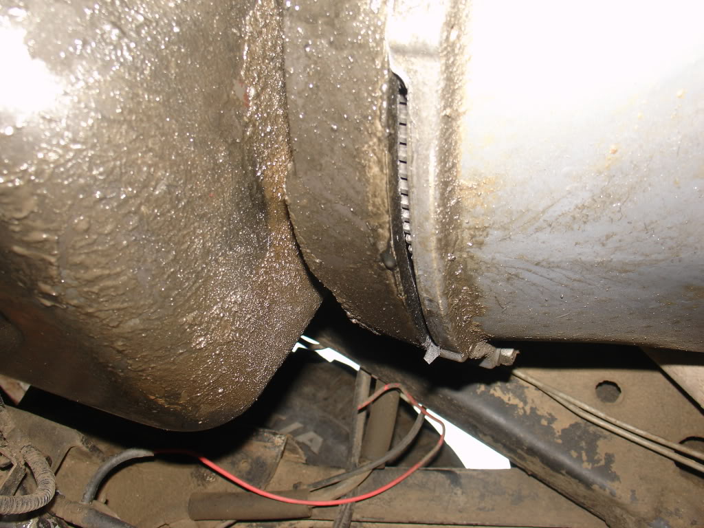

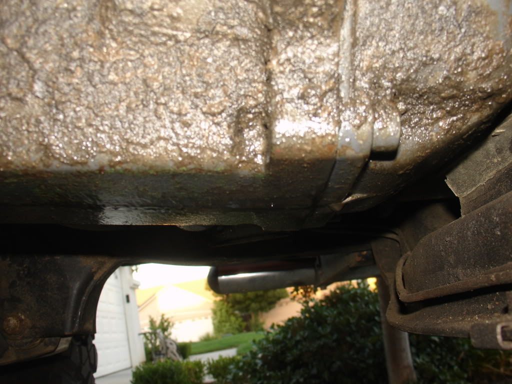

So the other day I walked out to my truck to go to school and there is a bigger then normal sized puddle of oil on the ground, in a rush to get to school I left it be and when I got home let it cool and climbed under it. Holy ***** was there oil everywhere up on the bottom half of the engine and tranny. Its not leaking it just seeps from what I can only imagine was caused by the kdp which browns told me would happen when they JB welded the small crack for me. But the oil is forming a drop at a seam in the tranny (pics included), I dont know the exact part of the tranny so Ill be taking pics and posting them. Is this normal? My clutch feels fine but ever since the day I got my clutch put in theres always been a real tinny noise coming from what sounds like the tranny and only makes a noise when I move. But my clutch feels completely normal. Help me out here guys! I need to keep this hog healthy! Thanks
Puddle:

Tranny seam where leak seems to be coming from:

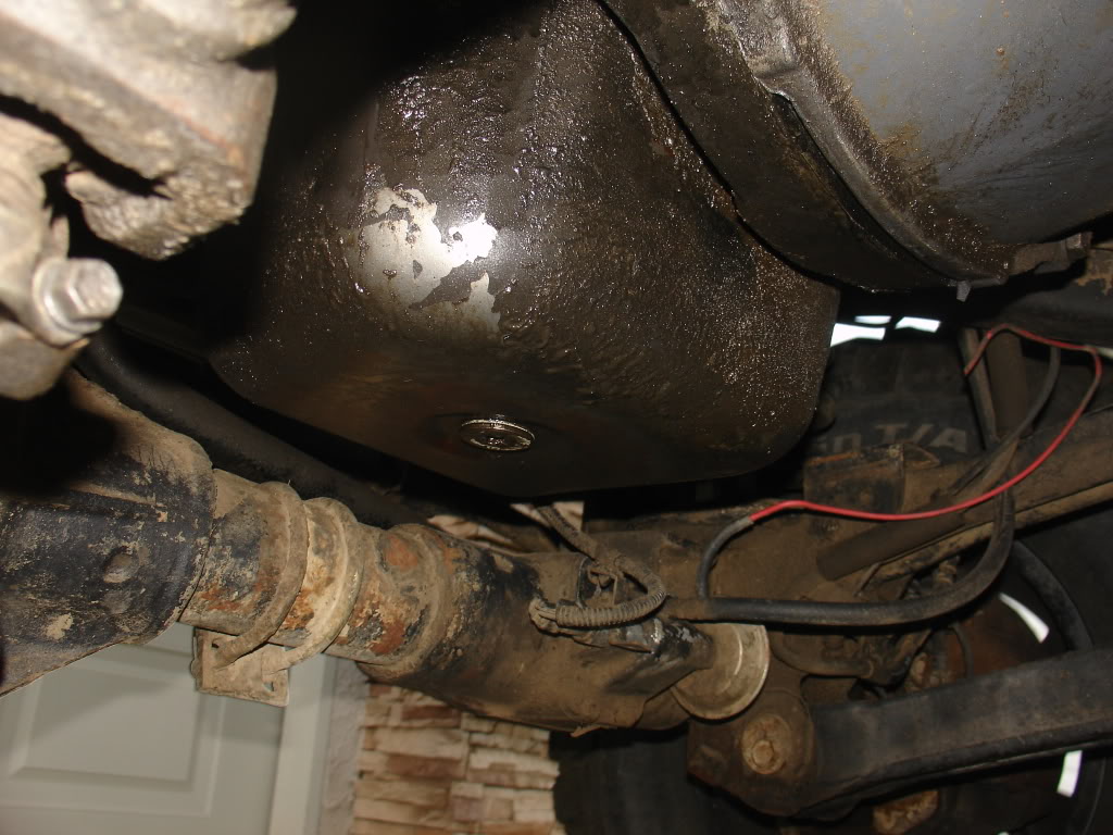

Other parts of the tranny covered in poop:

Based on the colour of the oil, I suspect transmission oil from the NV.. I would do as instructed and clean the thing off with a pressure washer and then see what happens. Could be as simple as the vent being plugged and the oil being pushed out under heat and pressure or the top boot on the shifter lever has a tear in it.

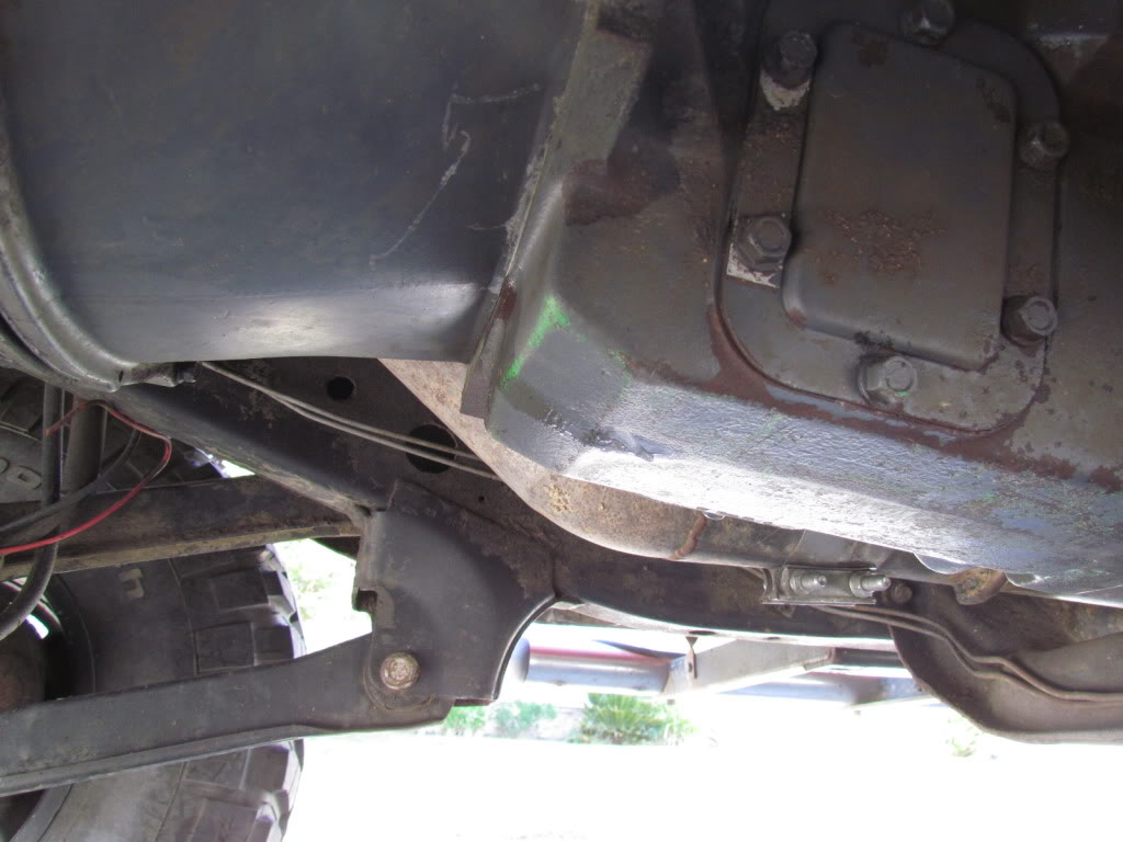

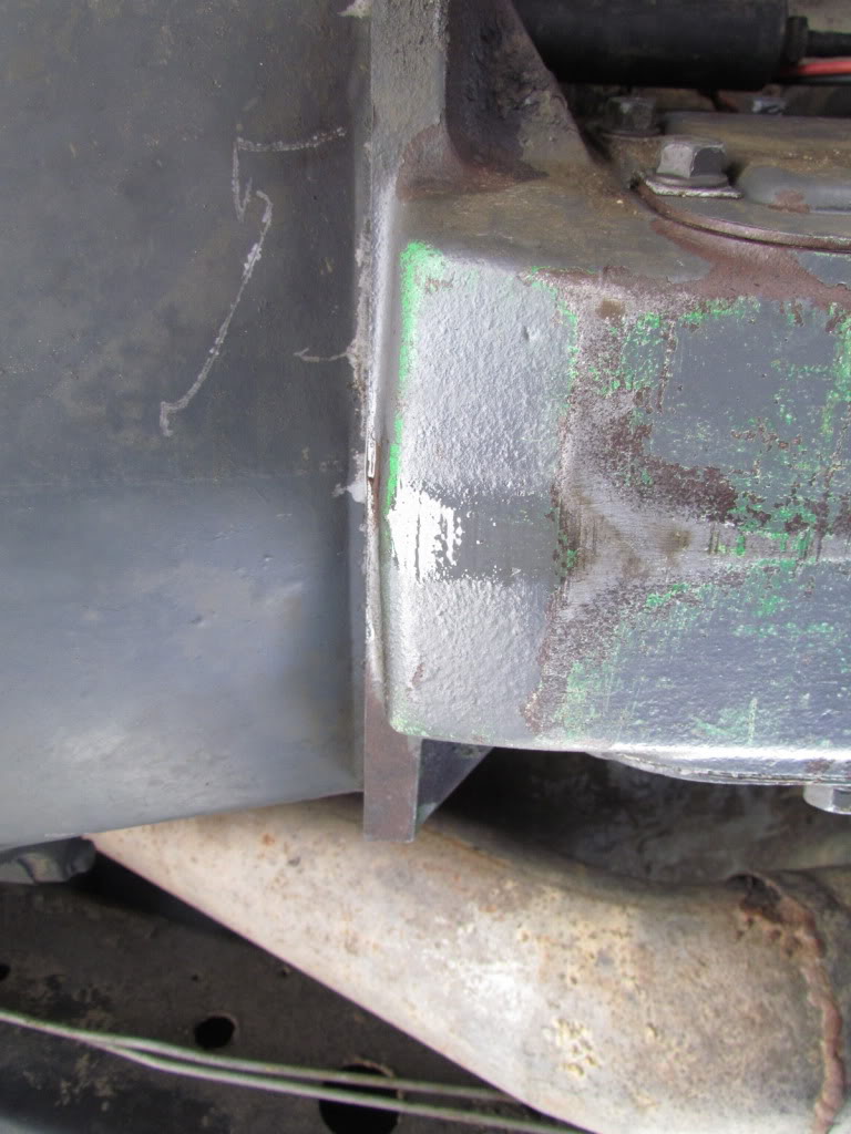

Well I just remembered I had a shop put my clutch in in may and they replaced the rear seal as well.
It looks like the rear seal to me, if it is I think ill be giving the shop a call and have them replace it at their expense. Three months for a rear seal? Dont think so.

Don't think so.. I am edging toward input shaft seal on the tranny. If the engine seal was gone it would be dripping out the vent under the ring gear. The rear seal will leak out onto the flywheel inside face and fling onto the bell housing and down out the hole. Been there, done that. This leak looks like its coming from the NV.

Gear oil coming from that area is possibly from the front countershaft bearing cover, especially if it continues to leak when not running. You can see the lower edge of the cover just below the bell housing. My 95 had a hole rusted in the cover. I drained the oil, cleaned the area well with brake parts cleaner and covered it with high heat silicone, been leak-free for more than a year.
