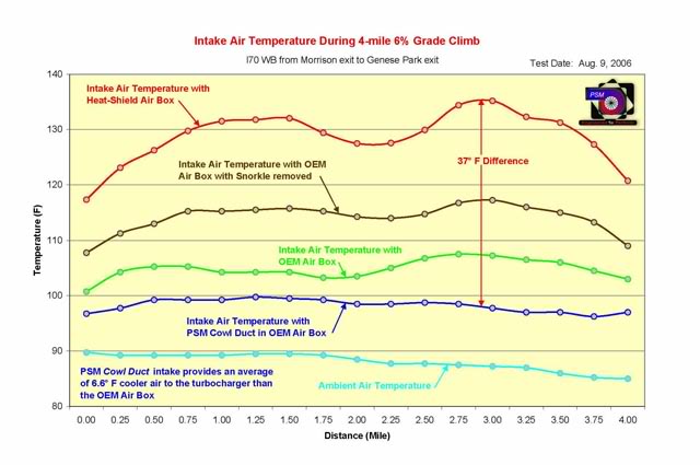

Top red line is with a BHAF
Dark blue line is with the firewall hole mod I linked to

Good read I picked out of another thread somewhere: http://www.dieselpowermag.com/tech/g...s/viewall.html
Infidel's mod is about as good as it's going to get unless a guy is running some serious power.
