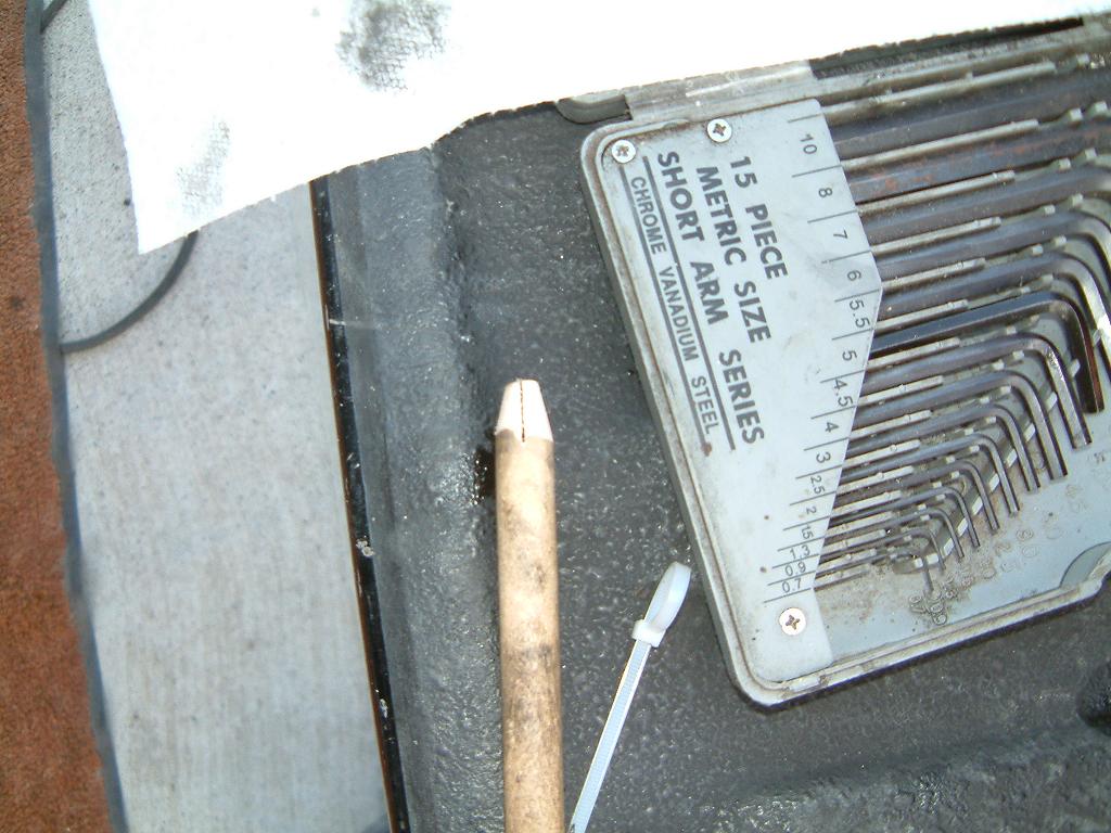

The dowels are easy to do once you figure out the trick to them. It took me about 90 minutes of messing around before I found on the internet the proper way of doing it. So I'll spare you some time.
What you'll need is a saw, and a belt sander.
Take your 1/2" dowel, cut it to a 12" length (you may need to adjust lengths, rearmost cylinders are the tightest), cut a slit in the end about 1" deep. Take the dowel to the sander, and sharpen it to a point like a pencil. The taper length should be around the same length as the slit. You take the sharp end and sand the point off until the diameter is around .300". Then tap them into the lifter. Give a decent pull on them to make sure they won't let go. A loose fit makes for a bad day. You can use rubber bands to hold two dowels together, I used zip ties.
You may also want to borrow a timing set to retime the truck when you put it back together.

clothes pins / fuel line clamps
