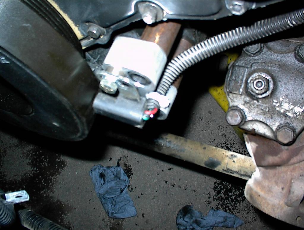

I put one on when I put in the g56 in but theres still alot of rattle with the big hub I made the tac brackett 50.is 50.00 heres what it looks like.
That's a nice looking bracket. Actually, I am intrested in installing a G56 to too (some day). I just can't over the difference with this damper.
