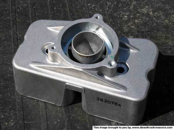

That crankcase vent is very simple at best. A single baffle in a box is all that's catching the oil mist (works by means of "Impingement") . . .
The 24v breather is mounted up where your oil fill is at. It works a little better but Dodge thought it was a good idea to put a bottle under it still.
There are other means of venting the crankcase but most of them vent from that coming first through the lifter-valley (valve-cover vents, lifter-valley, ect). Coming off the timing cover such as the 24v would be the other.
A Case/International tractor vent (Cummins issue) 2 valve-covers bridged with a single vent assembly . .
Another of a million .. .
