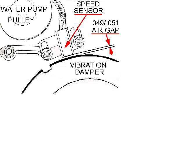

Check the wires, connector and gap for the engine speed sensor.
If they seem fine replace the sensor, auto parts store part.
If the ESS isn't functioning correctly the computer thinks the engine isn't running, nothing electronic will work.

I replaced engine speed sensor yesterday, have not checked gap with gauge yet, but it does read rpms and seem to work properly until the engine gets up to operating temperature. I will recheck air gap with feeler gauge as soon as I can. Thanks

Checked gap today on Engine Speed Sensor, wasn't off too far. Used this pickup to haul cows most of the afternoon, as soon as engine got up to temp 190 or more, I lost tach, AC, alternator and overdrive. Drove pickup that way all day today, last run of the day, I hauled 11 cows 18-20k with trailer, 50miles one way, no OD or anything whole trip with the load on. By the time we got cows dumped and headed for home, ambient air temp dropped dramtically. Down to high 60's compared to upper 80s. I got 4 miles down the road, and the check engine, water in fuel, wait to start and trans temp lights all came on. Those lights stayed on (no flashing) for 30-40 seconds then went off, I got overdrive back, along with alternator and all the rest. Drove pickup another 45miles after the od came back, no problems.
