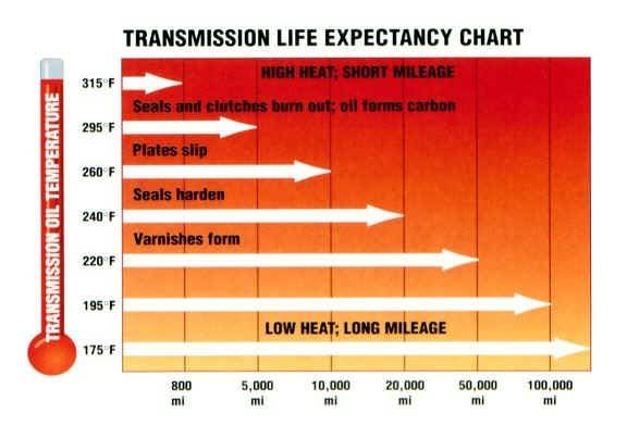

Temperature is the killer.
A couple of diesel tranny gurus have told me the cooling system on these trannys is excellent and doesn't need any improvement other than a bigger pan for more ATF capacity.
