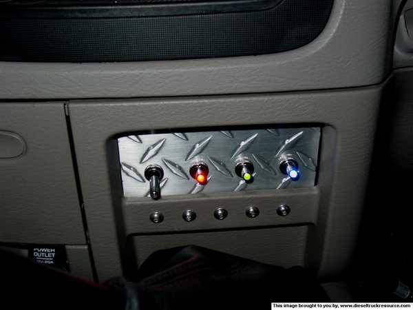

BUT you can rig up a toggle switch on the trigger wire if you want to kill the pump when you tune.....that might be the best way....
At last!
I have a new task for my fuel pump cutoff switch (3rd from left):
... originally was supposed to be a theft-deterrent, before I realized the CP3 would draw through the in-tank LP.
