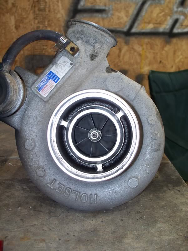

As for the wastegate, I'm going to assume you have a HX35 turbo since you have a 2000 5-speed. You can buy an adjustable boost elbow that replaces the stock one. The adjustable elbow allows you to restrict the flow to the wastegate actuator so that the gate stays closed longer. You could also just remove the stock elbow and plug the hole to completely disable the wastegate. I don't really recommend that approach as you don't want that HX35 pushing more than 35psi.
As a simple test, you can squeeze off the hose going to the wastegate actuator with a clamp or pair of vise-grips just to see whether you can push past 22psi. If your boost is higher with the line squeezed close, then the boost elbow will help you out.
EDIT: This is an example of an adjustable elbow on an HX35.

I honestly dont know what exactly your talking about in the picture..

The brass 90* fitting with the hose connected to it is a 'boost elbow'
It basically allows you to increase the pressure at which the wastegate opens. Your wastegate is the limiter to the overall boost your turbo can create... In short at least..

As for the boost elbow, if you look at your turbo, you should have a hose and elbow as shown in the picture. The difference is that your brass elbow has a much bigger opening that passes pressure to the wastegate actuator to open the gate when boost pressure rises. The elbow shown in the picture has a small allen screw that allows you to close the opening to restrict the flow, which allows you to run higher boost pressure before the wastegate opens.
