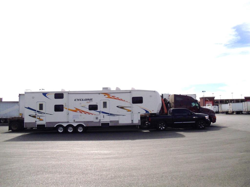

38 FT driven from coast to coast, no problems in parking lots or camp sites. The bigger problem is in cities, trying to make right hand turns from turning lanes when other cars are in their turn lanes trying to go left. They do kinda Treat you like a big rig and back up for you tho Just get a 5th wheel with an extended pin and you should be ok.
Very nice trailer. But I understand that Cyclone has some special turning radius marketing thing for short bed trucks which is better than most other trailers. Looks like yours sits nice too. What do you have for suspension support? And how far is your kingpin from the cab? Thanks for the picture.

Thanks for the kind words. My suspension is still stock but I will get airbags when I return from Iraq, along with a few other mods. I'm sorry I dont know the distance of the king pin from cab, I've never measured it. Heartland does have the 88 degree turn feature on their trailers tho and I've used every bit of it in certain situations. Anyway, best of luck on your hunt.
