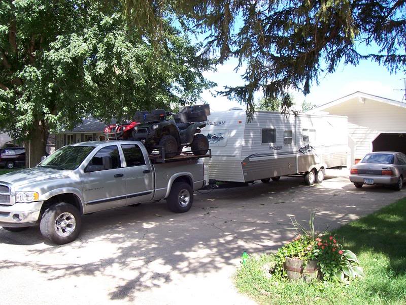

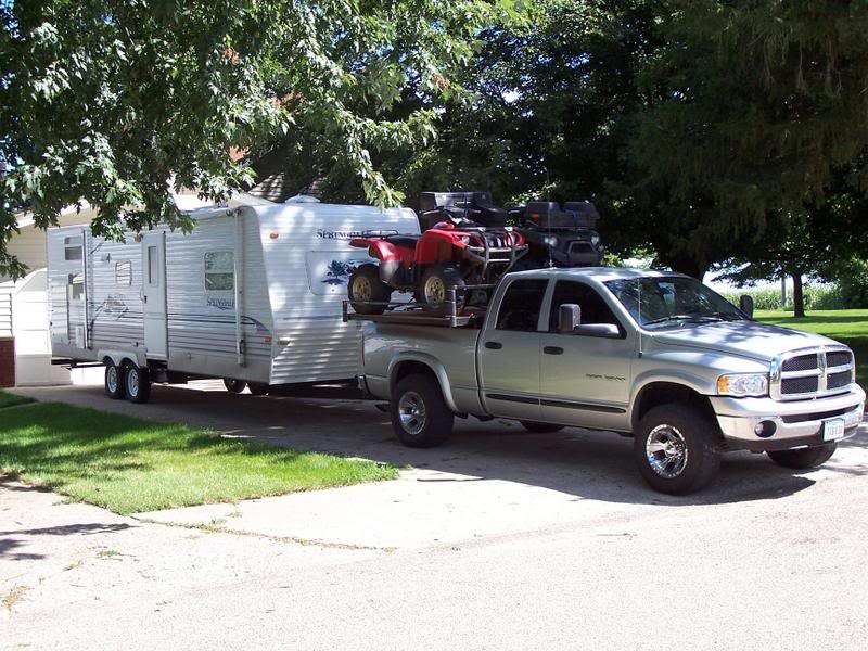

As far as puting a golf cart in teh box then pulling a TT that is no problem. This is how I did it before I bought my toy hauler. I pulled it 1800 miles round trip like this with no isues what so ever. I dident have a WD hitch or air bags. This is 100% stock suspension. Camper was just sitting on a ball on standerd receiver. With this load the truck just sat level. We even left the ATVs on the truck all week driving around Colorado and up Pikes Peak with no isues.
