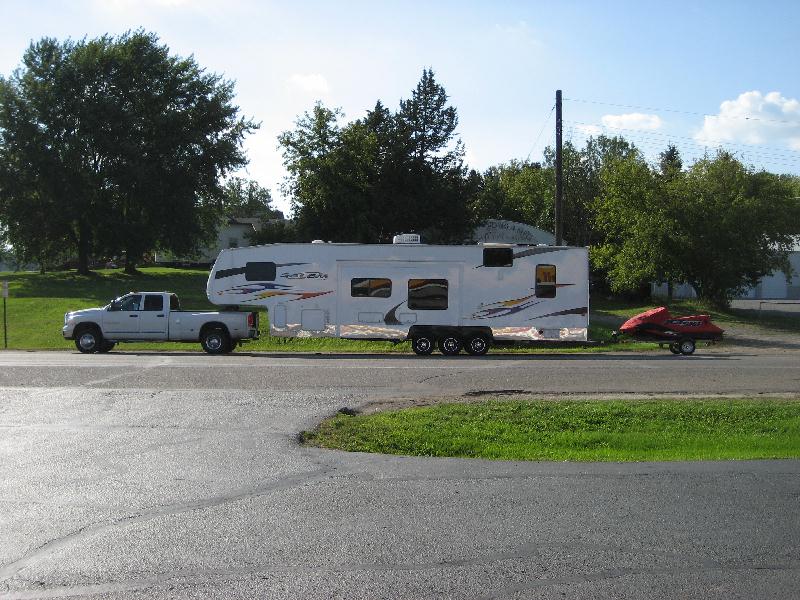

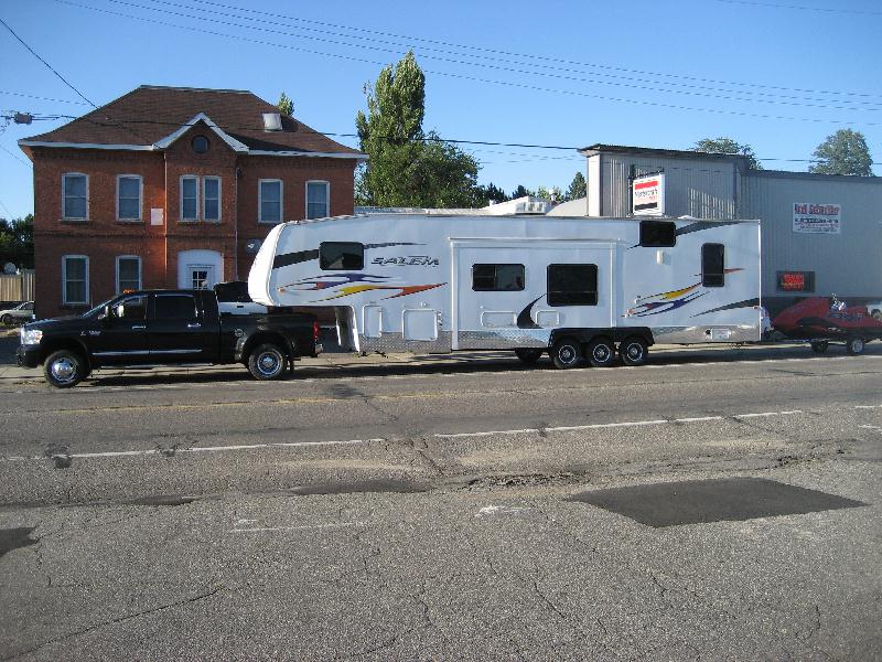

Gearing will play a big factor 4:10 would be my choice if you pull in any hills. I pull my toy hauler with my 07 without a problem its a little lighterAbout 15500 but i also pull my jetski behind it. I had 4:10 in my 04 and have 3:73 in my 07. I really liked the gears in the 04 for heavy loads
