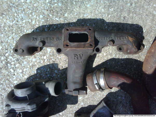

A '73 model huh? Cast or forged crank? Is it by chance a turbo rig? Allot of the Mopar equipped motor homes had a draw through turbo setup. Ask me how I know? How much of a mess can you make?
Turbo?????
Holy cow that would be awesome!!!
I haven't actually gotten a good look at the engine. But I'll be looking for that!!!

Here you go Ron. This is most of the components removed from the engine.
Nope mine doesn't have that and it appears to be a 413.

Ron, get me a pic of the water pump, front of the engine. What you may have is a 413 truck/motor home engine.
