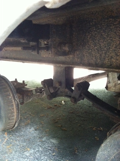

Discovered the equalizer shackles on our 5er badly worn with really elongated holes... So time to replace them. I plan to replace the equalizers, shackles, spring bushings, and all the corresponding bolts. I'm having trouble measuring the shackle size and equalizer size so I thought I would take one side apart to make sure I get the right size replacement parts (for example - I can't tell if I have 2 5/8 or 2 9/16 shackles). So two questions:

Thanks again everyone. I had to put this off because of knee problem, but finally got around to it today. I ended up going with the Dexter kit - it was about twice the price of the dry parts one at a time but as was pointed out - is greasable and came with everything I needed. Test drive afterwards seemed much smoother and definitely quieter - no more squeaks at every corner and pot hole. My old stuff was a time bomb, so I'm glad I noticed it. Could have been bad if that one shackle had finally come all the way apart at highway speeds. So I feel stupid, lucky and now smarter... all at the same time. Here's a couple pictures of what I had...
