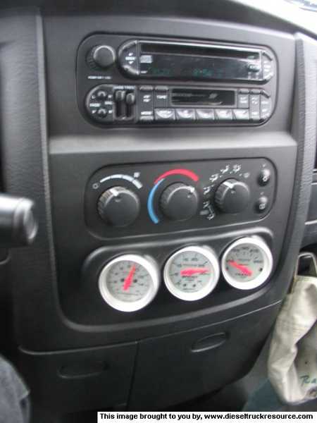

I feel the general consensus around here is if you don't have any mods then you really don't need gauges. Having said that, you are pulling near your truck's max rating, and gauges are somewhat entertaining. If you have $300 burning a hole in your pocket, a few hours to burn on installation, and don't mind losing some dash/overhead space then do it. You probably won't regret it as gauges alone shouldn't be enough to invite any warranty challanges from a decent dealer.
Here's how I did mine (went with Diesel Manor if I remember right, but Geno's is a good source as well):
that looks awsome

Originally Posted by kinser5mfan
that looks awsome
Thanks, can't complain.
(Just need somewhere to stick that stupid cellphone now...)
