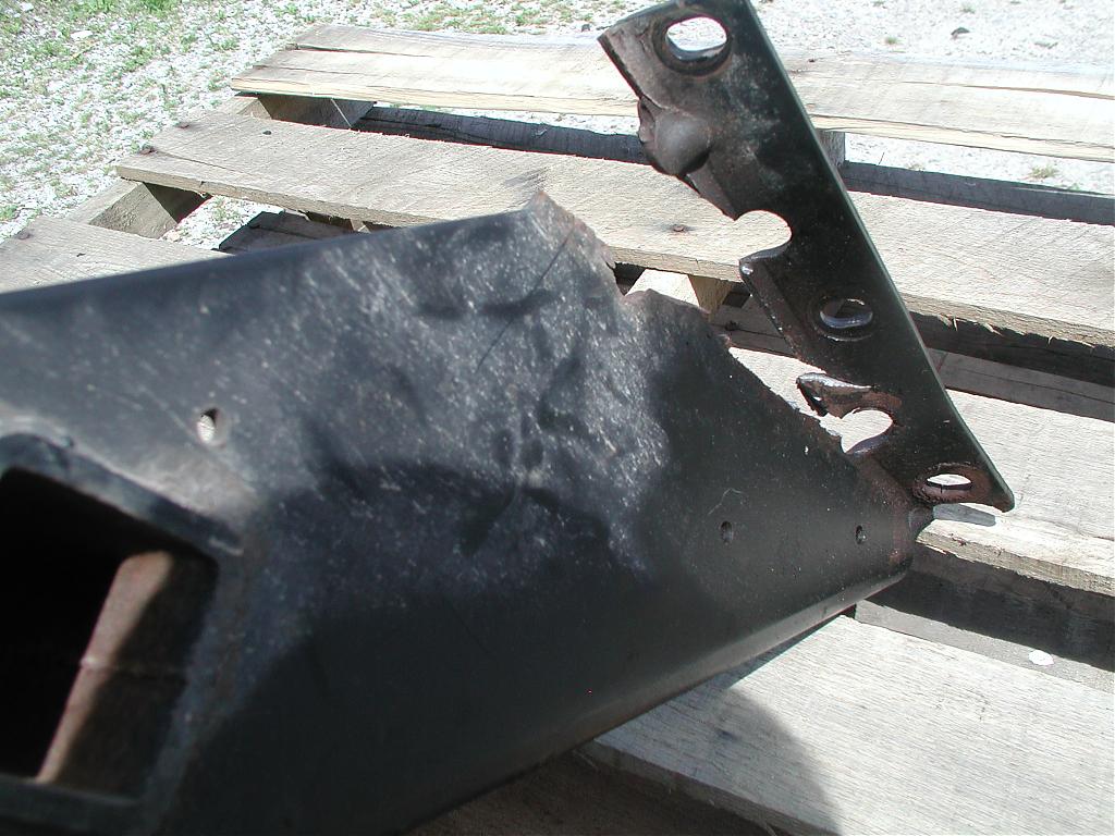

Pic of why you should check your stock trailer receiver hitch

Recall states 98-00 trucks.

There is probably a separate recall # for 94-97. They used the exact same 6 bolt receiver and the guideline for the repair is the same.

So I checked mine today 6 bolts no cracks to be seen even considering the grossly exceeded weight limit on it several times. Maybe its miles of towing and not just weight. Don't know

Originally Posted by macattack_ga
It's the stock class III that came with my training-wheel equipped truck...
I was carrying a 24' enclosed trailer w/ a lot of weight on the tongue and w/o a load distributing hitch. ~10k lbs total, but a lot up front.
What do you expect when you double the rated capacity of the hitch ! Recall or not, Class III is only rated for 5000# !

Discovered the same cracks on my 95 several years ago. Just dropped the hitch, welded the cracks and added reinforcement. No problems since, and the old truck works hard when it's working, hay trailers, fertilize buggies, you name it.
While the OEM 2nd gen receiver is listed AND advertised as a class 4, not a class 3, it is a moot point.
The point is, why is a 5000 LB weight carrying receiver installed on 3/4 ton and 1 ton diesel trucks? That is a major slip up by Dodge.
By reading between the lines, what they have implied is: "Here is your new 1 ton CTD that we have rated to tow 12K (arbitrary # for the purpose of this arguement) and we have included a tow package option that will allow you to tow 5K." To that I say: "HUH????"
And nobody cares about the weight distributing option save for some RVers. There are all sorts of trailers out there over 5K that should not be subjected to a WD hitch when being towed by one of these trucks. If the appropriate receiver was installed in the first place, that too, would be a moot point.

There are not many hitches that are rated 10,000 w/o a w/d hitch. My 97 was clearly labeled as 10,000 with w/d, 5000 w/o. I ignored the label and it failed the same as the OP's. My bad. I bought a heavier duty hitch and went on down the road. BTW, there is no standard for class 3,4,5 etc hitches so just making a blanket statement about what class hitch was stock, or what to buy won't fly. The hitch I installed is rated to 15,000. Some would say it is a class 5, but others say it is a class 4 because it is a 2". If you look at the major hitch makers websites you will see their class ratings do not come close to matching.

I had a similar problem. Dropped a 10K trailer onto my hitch on my '01 dually and saw it flex about 4 inches! Checked it out and it was the stock clss 3 hitch!! Checked my sister 2001 1/2ton truck and it had the EXACT same hitch on it!
I replaced the factory hitch on the '01 right away with a Putnam 14K.

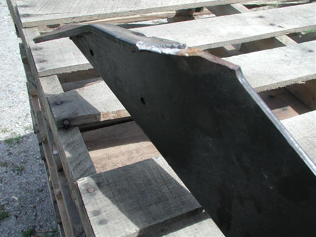

This is what I found on my 98 1200 mi from home (notice the rust on the first inch os so) & it would of took 7+ days to get a class 5 so I had to buy a standard one.
So where can I get a Curt hitch at?
Attached Thumbnails Pic of why you should check your stock trailer receiver hitch-hitch-001.jpg   Pic of why you should check your stock trailer receiver hitch-hitch-002.jpg
