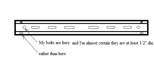

Those are universal rails, used by a number of hitches. If properly installed you should be able to buy a hitch (even used) that can be installed to them. While the bolts do seem undersized, it may be an optical illusion. They really should be about 1/2" diameter I suggest you go to a hitch company website, such as Husky or Reese, and try to download an installation manual. Study it a bit and gain a little information. Sometimes when you install a new hitch on existing rails, you have to loosen some bolts to allow shifting a little so the tabs can mate with the slots. Make sure to tighten everything down again, including bolts you didn't loosen, just to make sure all is secure. The weight of the trailer puts lots of stress on everything, especially when braking.

As an additional note. Perhaps the reason the bolts seemed odd is that mine are through the center of the rail, rather than the edge holes, like my drawing
