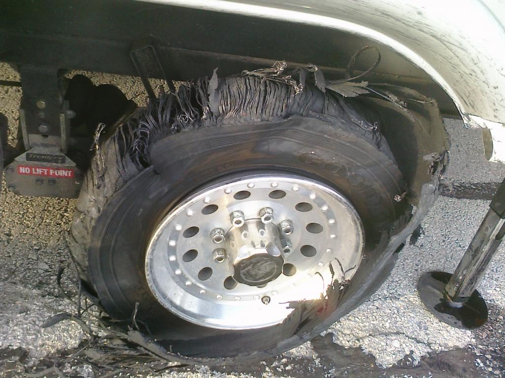

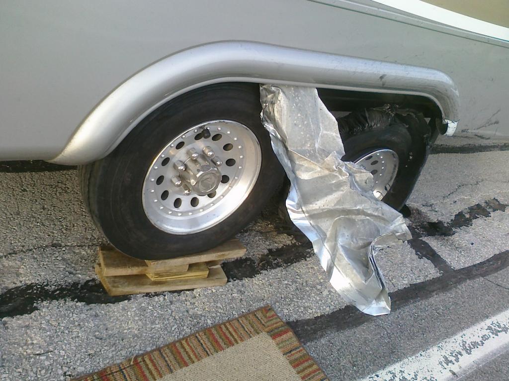

The rule for trailer tires from I hear is 5 years then replace. Well I thought the same as you, "if I keep them covered they will last" This is what was left of a Goodyear G114 17.5" tire after 6 years, they still had a bunch of tread and ZERO cracks, I have Pressure Pro monitor on them and the pressure was set perfectly before it blew. I think my damage was minimal for a 125 psi tire blowing out, BUT I do have four new tires on coach now, these were dated 0505. I will not run them over 5 or maybe 5.5 years again. I store this coach in the barn when not in use and the tires are covered by the slides when in use.
