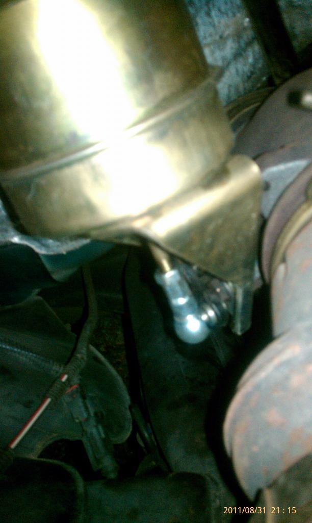

I said I'd never install one of these brakes on my truck because of the Vacuum Pump failures. Well, I did install one. When installed you could not hear it engage with the engine temp below 170 at idle. The installer pulled the pin on the adjustment arm and turned it in 3 turns and replaced the pin. It was audible at that setting. I had to go to the Dodge Dealer to reprogram the computer so it would work properly. It does work good, but, does not hold as good as the one I had in my 2000 Dodge.
Does anyone have any info on how many turns and in what direction from a given point, it needs to be? or
EDIT; Count the number of threads from the vacuum can to the lock nut on the hyman joint arm that actuates the lever that closes the disc in the exhaust elbow.
I have called, written, e-mailed, both Jacobs and Cummins with no responses.
Figures.
Thanks in advance.
Dave

Yep, its a Jacobs exhaust brake. It was purchased new. Did you read what I wrote? Yep, when working properly, you know when its engaged. My last truck had one. Did 203,000 miles with it, so I know how its supposed to work. The adjustment was changed as stated previous, because the arm did not move far enough to hear it engage when the engine was cold at idle, which it is supposed to do up to 170 degrees. Apparently it came from the factory that way. There is a hymen joint with a lock nut on it which is threaded down from the vacuum can. Yep, it would be nice to know what the precise angle is supposed to be It did not work at the factory setting!
I have contact Jacobs and Cummins numerous times via phone and e-mail. No responses. Matter a fact the first thing the installer did was to contact both Jacobs and Cummins with the same result I got. If I put it back, and I know which way and how many turns, it will not work. Its a Cummins Part, bought from Cummins. The local Cummins shops don't really care about it as no one I've talked to in parts can even find one in the system. Cummins in Tampa told me they don't make them anymore?? I don't know if I belive that or not.
So I'll wait around until either someone knows something or put up with what I have. EGT's are normal, so the disc is not to far at this point. I may give it another turn on the arm adjustment.

Dave you might have to remove the brake and look at it there should be a orfice in the butterfly if there is add vacuume to the diaphram and see if its closing all the way if not adjust it till closed you will also see if there is a problem with the butterfly valve itself. hope that helps.

as they stated above you will have to take it out and adjust the linkage so that the butterfly is at the right angle to have the least restriction to flow and fully seat when energized. the best thing you can do is throw it in the trash and get a bd. the bd will hold 60 psi all the way to idle going from a jake to a bd will be like turning on a light switch. that pump is expensive and fails often. if the diaphragm fails it is not to bad but when the pump fails it locks up and burns the serpentine belt up before you can get stopped. if you keep that piece of junk on your truck carry a stock belt with you to bypass the pump when this happens. i was near Pecos Texas when one failed on me it was on a Friday night no one had a belt or pump it was Tuesday before i jot going again a four day vacation in July in Pecos Texas on foot is not my idea of a good time.

Manually re-adjusting the butterfly is an option but what you have to be careful of is making sure that you set the valve at just the right "maximum" angle or what you can end up causing is the butterfly to get in a position where the exhaust pressure pushing against the valve will stop it from being able to overcome the pressure against it and will stay closed until the pressure reduces. For this reason, some EB butterfly valves will not "fully" shut and this is also why there is other types of open/close designs.
