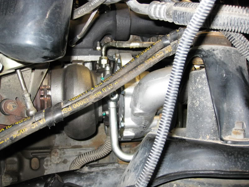

I can't take a look at it right now, but here's a pic.

Thanks for the pic. I took a real close pic of mine and I'm 5 going on 6 threads remaining. Looks like yours (blown up) is 4 going on 5. So as I thought, mine is real close.

More threads would be less engagement, and less braking. You really need to hook up a back pressure gauge and see where your at. You could be over or under braking, and neither is desirable.
