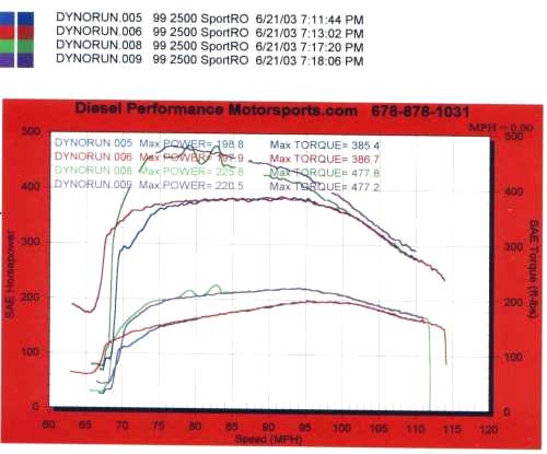

Originally Posted by RickCJ
neveragain
I've been to several diesel dyno meets and a stock 99 will be around 150 at the rear wheels .
The top two runs were bone stock (198.8 & 197.9hp) The last two were with a borrowed VA box. I guess I must have got a good one.
I do tend to agree that he needs to solve the overheating problem first.

MCummings's Avatar
Joined: Feb 2003
Posts: 1,123
From: Laredo, Tx, 7 hours south of Dallas
Generally, BONE STOCK, will do about 170rwhp, and with a COMP about 330rwhp.
I don't know what mine did stock.. My first dyno was 456rwhp, then two motors later, 516rwhp, then decided for some bottle, and did 588rwhp. hehe..
