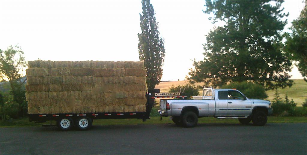

Strap 'em down. I look at the trailer springs and as they approach "flat" I back off. Then I take it slow. If I remember correctly this load was about 22K GVRW. Not a big deal in terms of weight but it was a bit tippy due to the terrain here in North Central Idaho.

Stack it nice and tight, then strap it down well. If my last row is the direction of IDhorsehaulers, I run about 4-2X6's length wise to hold them in place.
