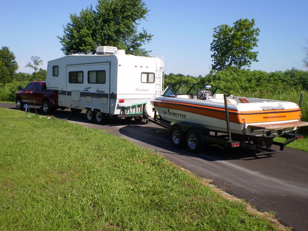

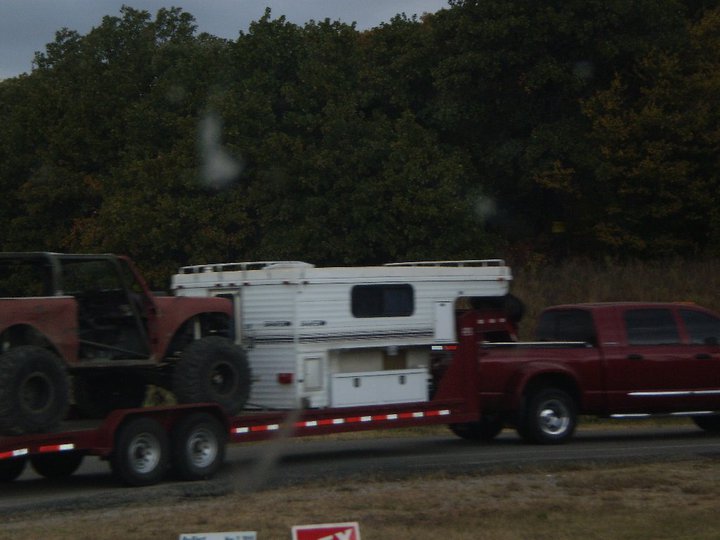

Ok guys/gals here is my issue, I have 3 hitched in bed style trailers. 2 are g/n and one is 5er, my issue is that I use all of them quite a bit and I am tired of taking out the Companion to use the B & W. I pull the 21' Malibu boat behind the 24' Coachman and thought that the Companion would help w/stabilazation of 5er w/boat behind. So my question is "What would be the best fix for this problem? Change 2 g/n to 5er style or convert 5er to g/n style? Would I have any issues w/either do you think? Or would one way be better than the other and why? Here are some pics of what I tug around and a thread w/dump trailer picture.
