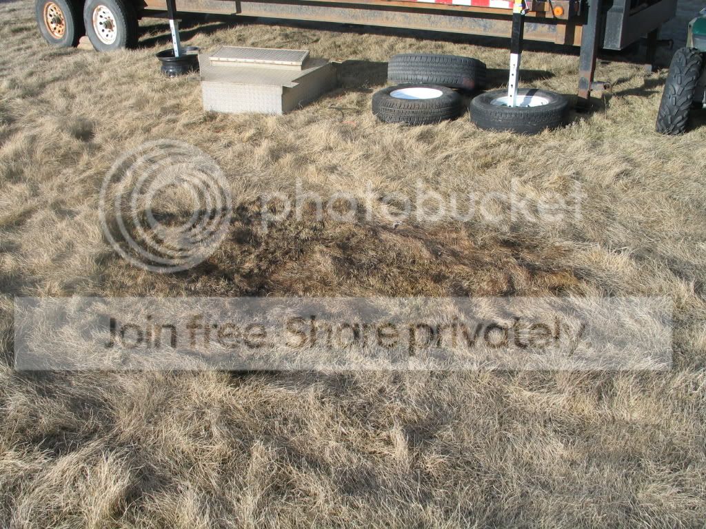

Last summer I invested in 2 fire extinguishers. I'm always doing goofy projects involving grinders/welders as well I run a grass cutting business in the summer and figured it would be a good idea to have one in the truck in case I started a grass fire. Well today having that extinguisher paid off. I was doing this project at my parents acerage and was a fair distance away from the house. I was on top of the neck of the GN trailer grinding off the spare tire mount when I noticed that the sparks from the grinder had ignited the grass. There was just a small spot about the size of a dinner plate burning but with the stiff wind that was blowing it was quickly growing. By the time I got down off of the trailer it was about 4ft in diameter. I started to stamp it out but was only making it worse. I started for the RV to get a pot of water but then remembered I had drained the tanks. I started for the house thinking to get a jug of water but knew that by the time I got back it would be WAY out of control. Finally I remembered the fire extinguisher in the truck. I grabbed it and in no time the fire was out. By the time it was all done I had a burn patch about 10feet long and 4feet wide. This all happened in probably less than 2 minutes! I spent the next hour mounting my weed sprayer on my quad and soaking the ground around where I was working with soapy water before even going near the grinder again!
