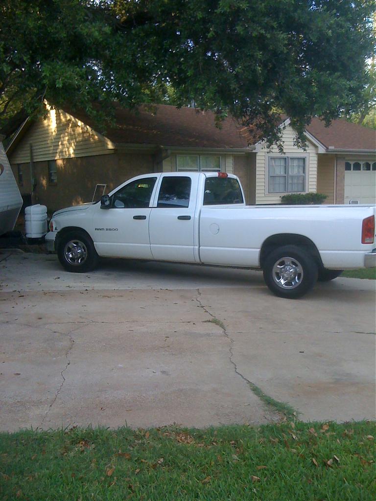

did u get a side pic showing the new clearence yet?

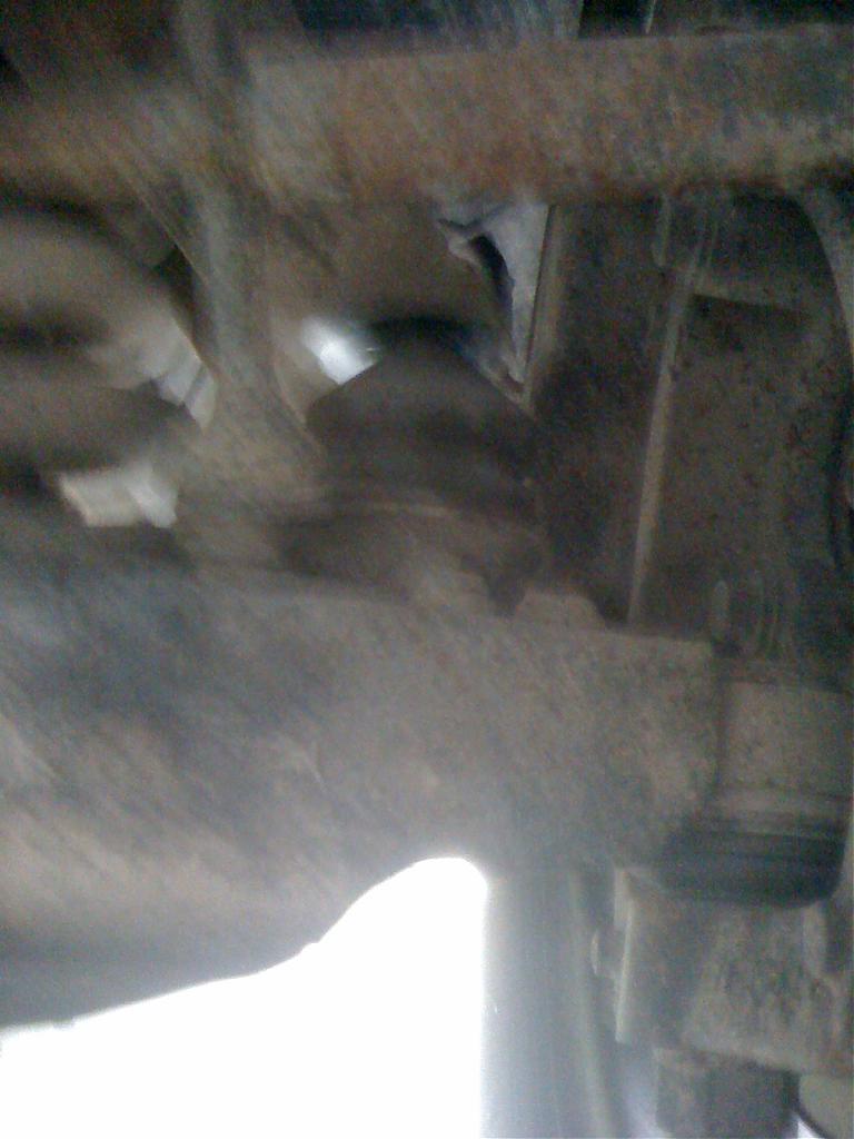

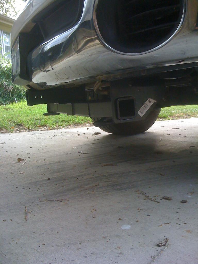

Here's the pictures. The first one shows the hitch cut up into three pieces. The second is a pic of the end of the frame with the spacer pushed up out of the way to access the hitch bolts, much easier than drilling an 1 1/2 inch hole in the side of the frame to "fish" the bolts through. And the last picture is of the hitch installed on the truck and finished. It's pulled up to a curb/sidewalk were I work. This is the same spot were I was 1/4inch from scraping with the hitch unmodified.

Pulled the camper out last night with my modified draw-tite hitch. Worked great and gave me plenty of ground clearance with the foot still connected to the jack.
The front bump stop is just starting to touch, you could slide a piece of paper through but that's it!

I'm glad to know you're not bottomed out, and that it worked for you. That's good news.
I doubt the springs are different.
But you could put Timbrens in place of the bump stops.
That tow hook set up is slick!

Here's the pic's now that they are working again....

Looks perfect
