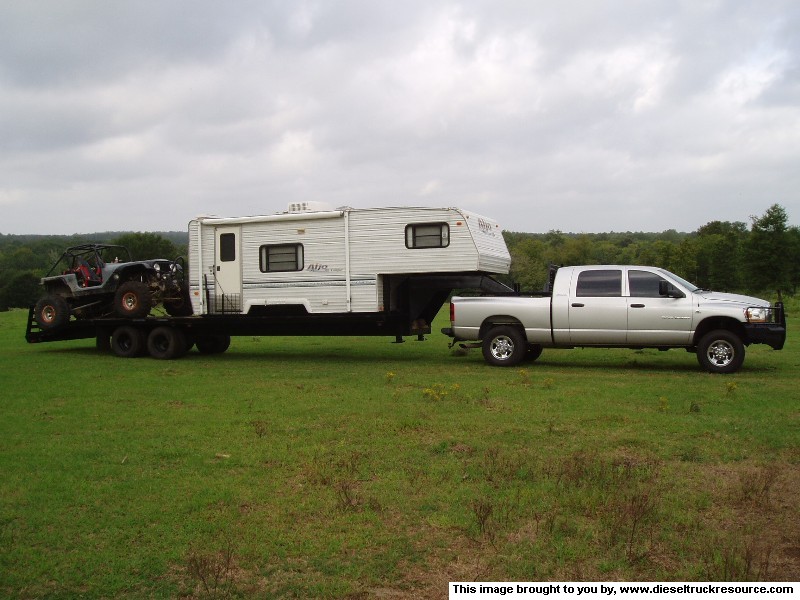

This fs2600 WW trailer im about to purchase does have the 5'' C-channel frame reinforced with 2x2 tubing. The fs3000 models have 6'' C-channel frames.
Have you seen any 2004 or newer trailers frames failing?
It sounds like there may have been a problem with the earlier ones.
Maybe I will take Drillpipe's idea and do this with my older trailer. I bet this frame won't bend. Seriously I have been considering it!
