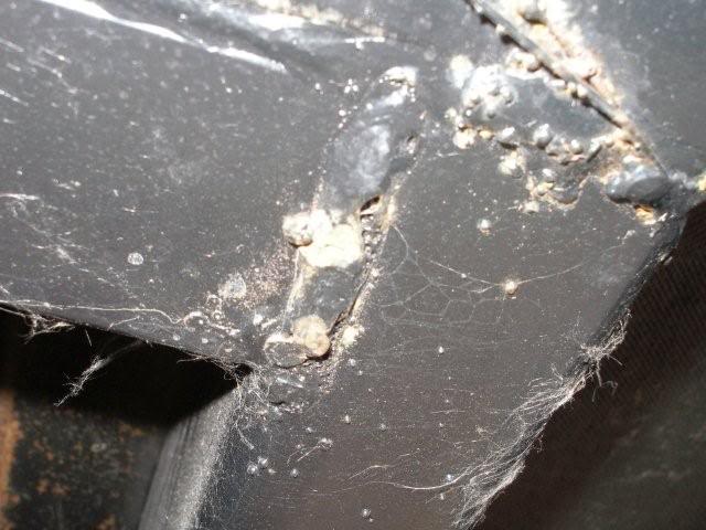

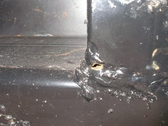

Here is a couple examples of the welds some manufactures consider quality

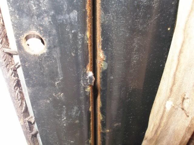

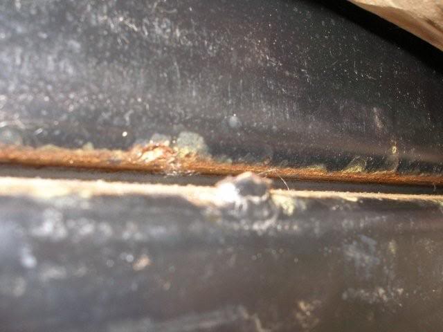

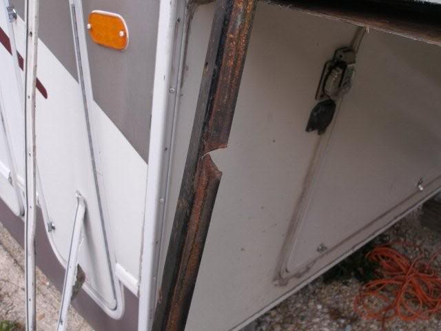

If you are getting used and see any movement in the front closet or movement up and down on the pin box going down the road here is a likely cause

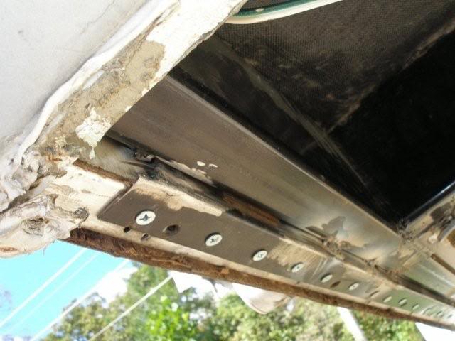

Here is what I did to repair
This would have been about $2k repair at a dealer.
