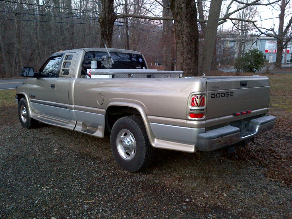

Ok guys, I purchased an 02 2500 2wd auto QC... Got a great price, and low miles, no rust southern truck. I know about the vp44 issues, and I will be installing a Fass lift pump and full gauges shortly. I looked a quite a few 12v trucks, but most of the trucks were rough...
With regards to the 47re tranny, is there anything I should be doing with the transmission to help it live the towing life. The only thing I did with my 48re was add a deep Maghitech deep tranny pan. 135k on it with no issues at all.

Nice looking truck.
Assuming your trans is solid, the best course would be to add a Valve Body and Torque converter from a reputable company, in addition to the deep pan. Will it require both? Probably not, but my luck with Murphy hasn't been the best.
If you have done well with your 48RE for 135K, I might be tempted to do the same with the new one. I lost the TC on Brownie towing sporadically at heavy loads.........
