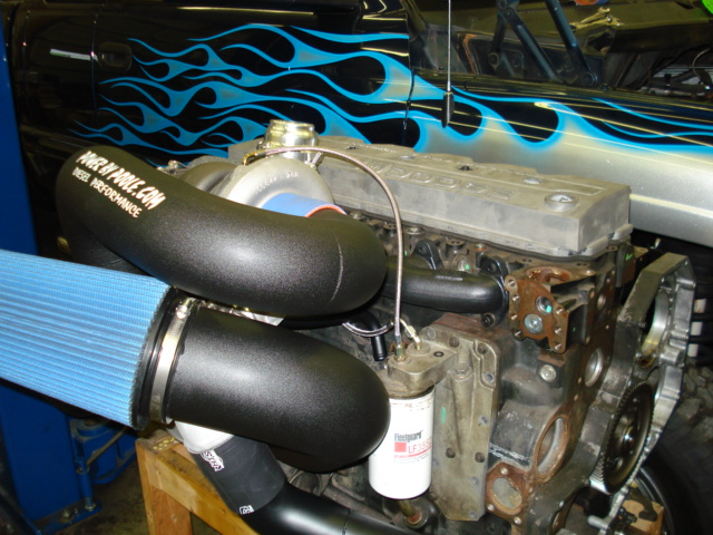

High Tech turbo 62/12 will work great as a starter turbo and top turbo in twins. Here a HTT 62/12 in twins
