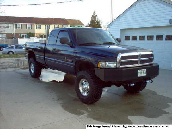

Old Jun 9, 2007 | 11:18 PM
Dave88LX's Avatar
Joined: Jun 2005
Posts: 852
From: York, PA
Like this.

Old Jun 11, 2007 | 04:01 PM
floridadieselki's Avatar
Posts: 124
From: florida
Originally Posted by Dave88LX
Like this.
Hey?!?! THATS MINE ! but i am actually thinking of going bigger, so the 38's are on the market.
Old Jun 11, 2007 | 04:16 PM
Dave88LX's Avatar
Joined: Jun 2005
Posts: 852
From: York, PA
Oh jeez you have 12" of lift! How much bigger are ya gonna get!
Fuel mileage? Nevermind, read the rest of your sig and fuel mileage isn't much an issue for you anyways.
