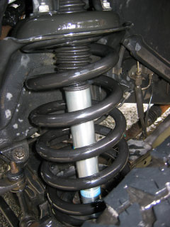

I had http://www.coilsprings.com make me a set. They look way better then the D25's, they don't have that stretched out look, and are custom to your specs.

I don't recall the specific number, I wanted them close to stock ( No plans for an aftermarket bumper or winch ). They were able to get the info needed off of the ID sticker on the stock springs.
I am very happy with them, appearance and performance! I also had them powdercoated before install.
