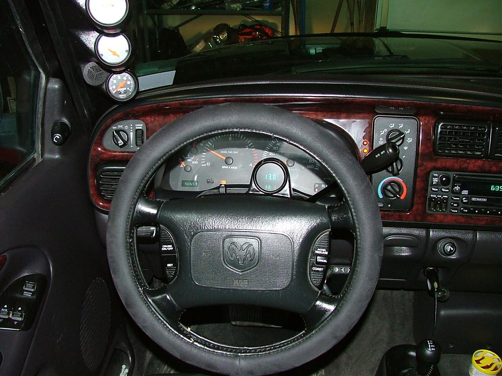

I use two LEDS. My yellow LED will turn on whenever the PCM or I manually give the signal. My red LED will turn on when I throw the L/U switch, reminding me "Red is bad, turn me off before you come to a stop"!
You can see my LEDs in this pic right above my shifter.

Thanks. I got from a TDR member more than a couple years ago and it's been flawless ever since. I wouldn't run a L/U switch without the LEDs letting me know when I'm manually locked. It's easy to forget sometimes, even with the bright red light staring right at you. Don't ask me how I know.
