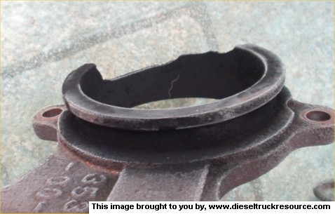

Well my Megamouth downpipe came in today, and I have to say, its an impressive piece! I'll start at the beginning though, for those who don't know why I bought this pipe. My downpipe hanger had broken off from the pipe, causing stress to be placed on the turbo flange, which cracked. The piece that broke off was long gone out the exhaust, and the flange is cast, so welding wasn't an option. To get a replacement flange, a new turbo is necessary, $1200 from the dealer! I could have purchased an aftermarket turbo for less, or purchased a used one on ebay with unknown mileage and wear. Then I found out the Megamouth downpipe includes the flange! The pipe wasn't cheap at $329 for the 3.5" version and $354 for the 4" version. They also had just the flange and elbow available for $199, but I would have still needed a downpipe. I went with the 4" full pipe, figuring for the extra few bucks, I'll be prepared in case I ever get the bombing bug. Pic of the cracked flange below:
