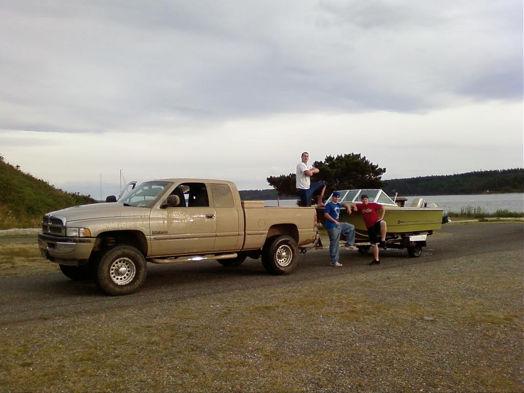

here's my truck!.. not as nice as a lot of the other ones in here, but i'm proud of it!

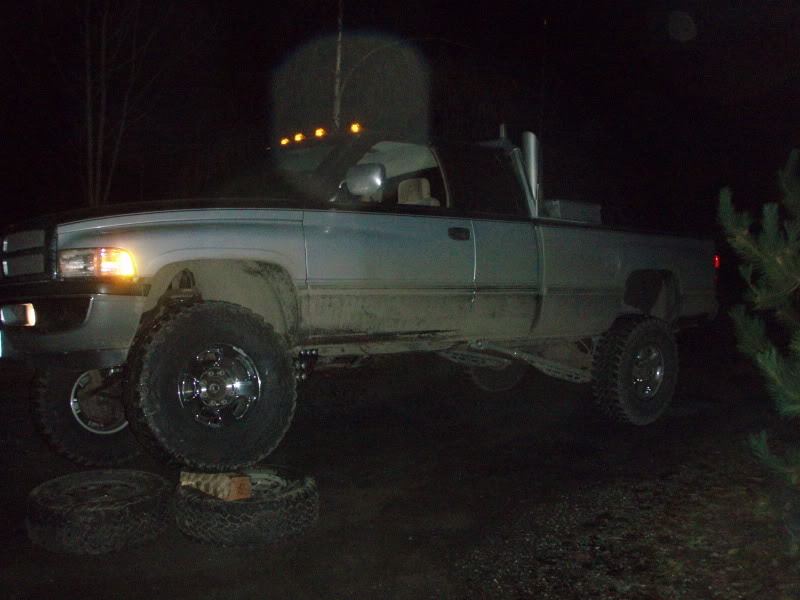

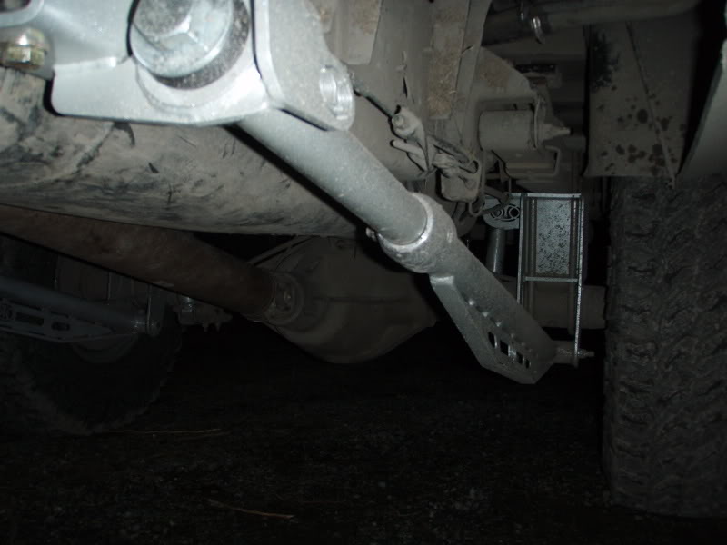

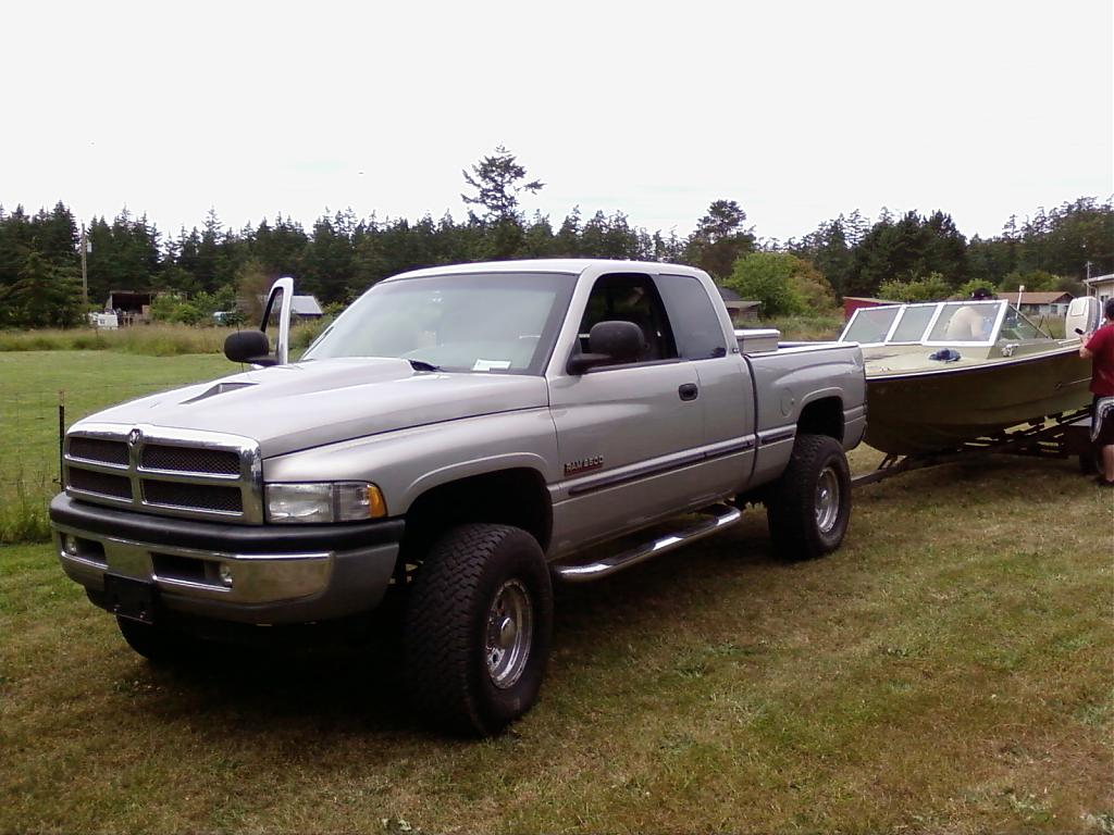

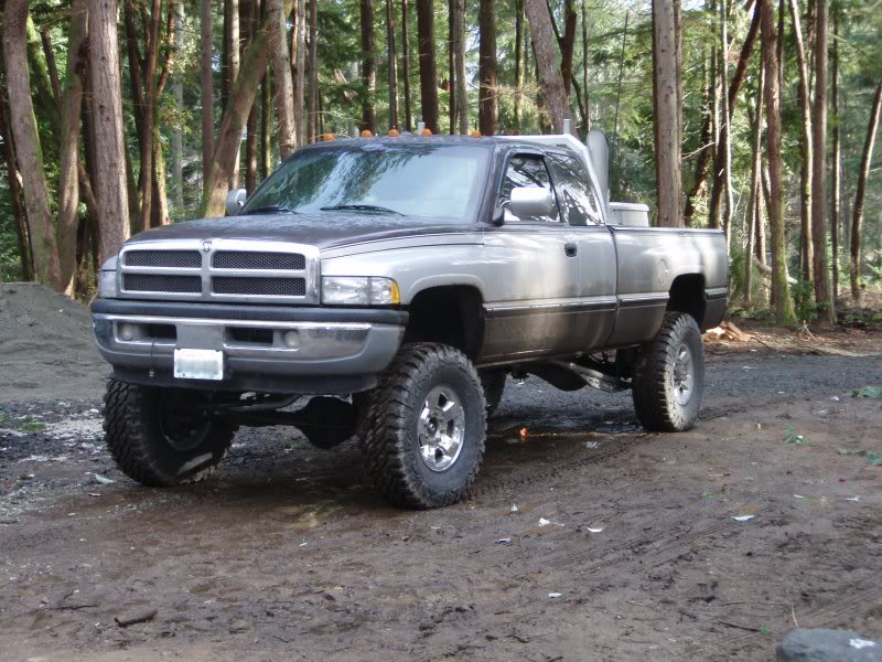

Juiced-
Your truck looks great!! Love the look of a lifted dually.

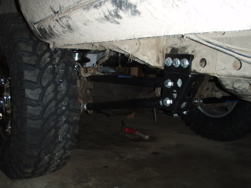

Here is mine, didn't have a chance to get it all cleaned up, but then again it's never that clean.
Revtek 6" lift coils for a 3rd gen
Rock Kralwer long arms
Thuren Fab track bar
One Up Offroad 8" traction block system w/ 3/4" ubolts
Bilstien 5100s
SJ extreme drop pitman
DSS
Pro Comp extreme M/ts
3rd gen 17" aluminum wheels
Still have to get the front sway bar sorted out, limit straps, remount the brake and ABS lines and shim the carrier bearing. Maybe get a new front drive line or index the t-case

I have not see those long arms before. How do you like them? hows the ride and how was the install? What size tires are you running? Do you know if your 6" lift was actually 6"? I know the 4.5"s on both our trucks one turned out to be 6" the other 6.5"

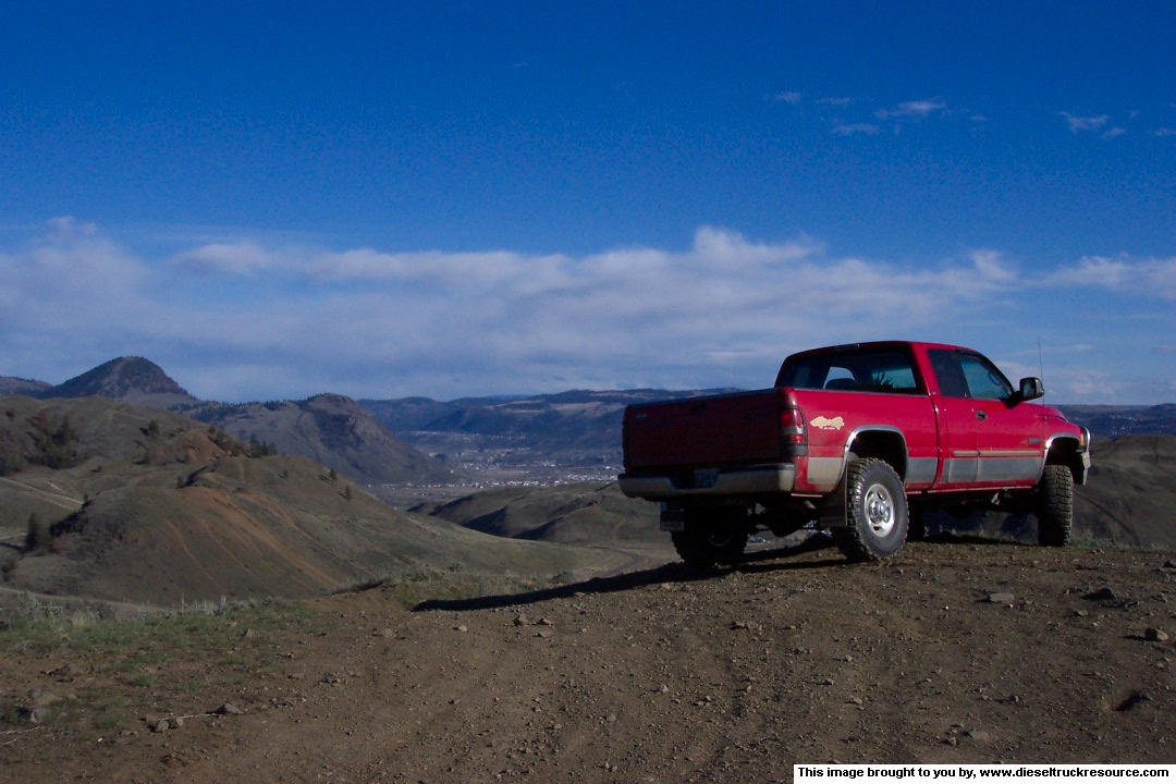

my dodge. nothing fancy. i'm gonna build a lift for it and run 40's i hope here once the lil one gets out of the baby seat and into a real one.
this is an older picture with the stock rims and the xterrains on it.

i really like some of the things you have done here. if you don't mind me asking on the traction bar is that the adjustable coupler mid way there that i see?

The bar telescopes so you can mount them where ever you would like, each piece is some where around 44" but I ended up with a total length right around 60". The frame brackets are designed to be used on the open part of the frame, the next good flat spot past where I mounted mine is in a boxed section of the frame. They connect back to the fully welded lift block that is secured with 3/4" ubolts. The center coupler has a 1/2 bolt running through it that crushes the outside tube in. The bars are made by One Up Offroad, they are very well made, super tough and the service over there is top notch. I wanted to keep my overloads and when the standard ubolt flip that comes with the system had some clearance issues Dave went ahead and designed a new skid plated ubolt plate the day after I told him about it. I should have it sometime next week.
I can't remember the numbers but I got right around 6" of lift in the front and just under 4" in the rear. Its a little low in back but I'm thinking the coils should settle in a little bit. I was going for level but maybe a big bumper will help
The RK arms are okay. Like I said in another post, I don't think there is a perfect long arm out there for these trucks. DC makes the only real off the shelf long arms but I was told not to order them by their main vendor due to QC problems. Not to mention guys that really use their truck end up remaking them w/ stronger material.
The ride is better than stock and they will work for how I use the truck. thats why I bought them.
Tires are 37X12.5/17

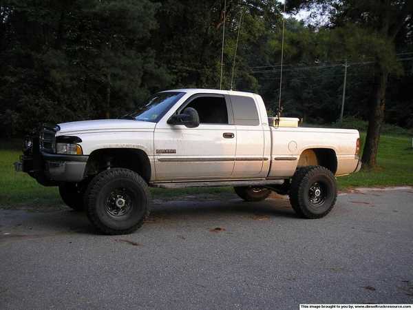

Nothin as crazy as some on here, but it's mine. It will come down a little before to long, plan to put cut or go with fiberglass fenders so I can still run the 37s

How much lift is that?
